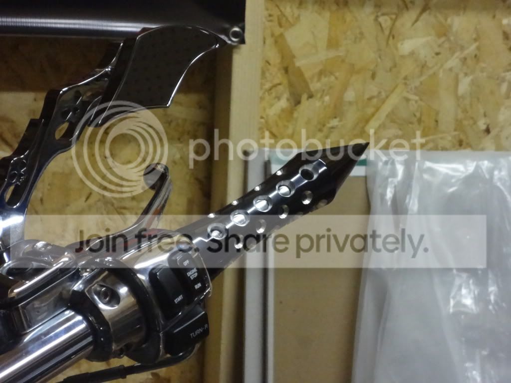

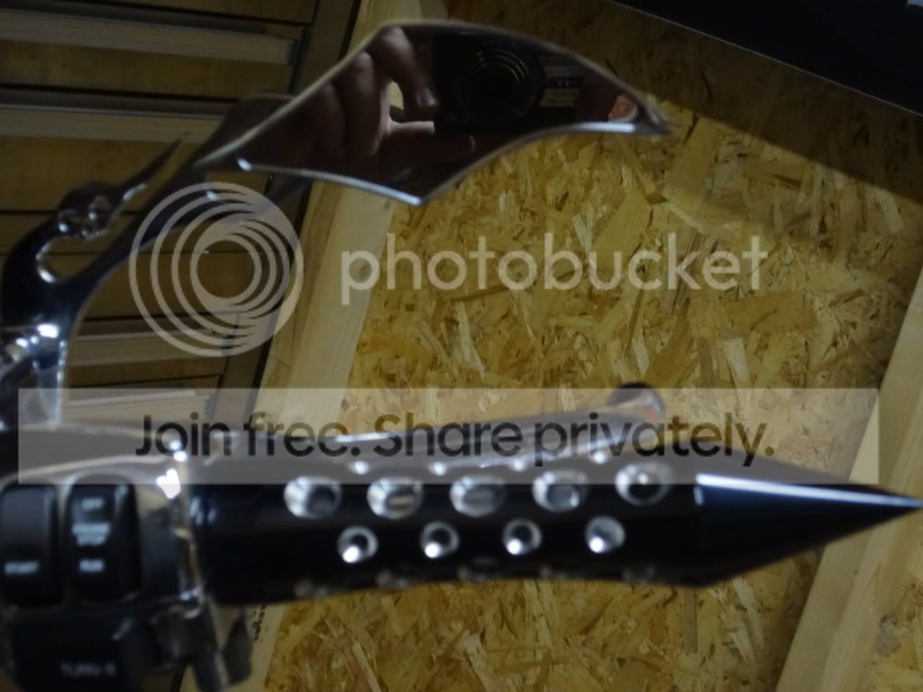

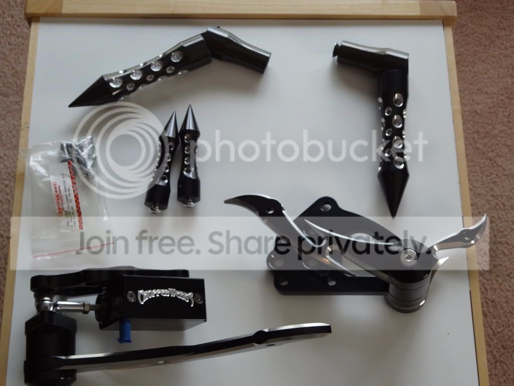

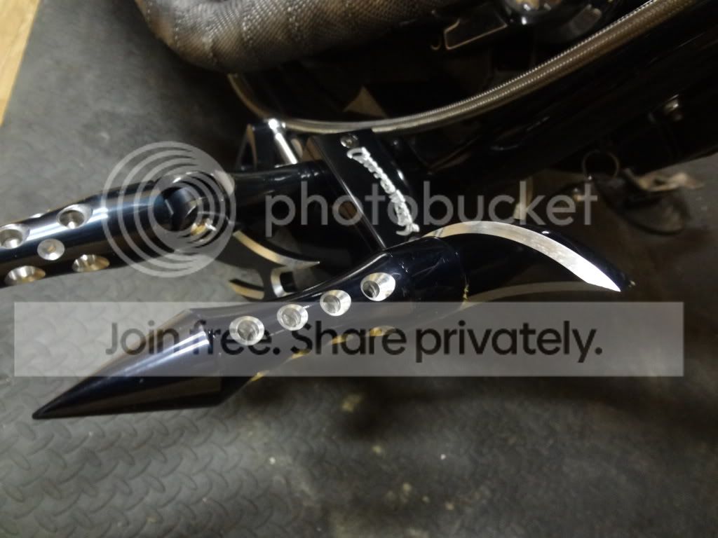

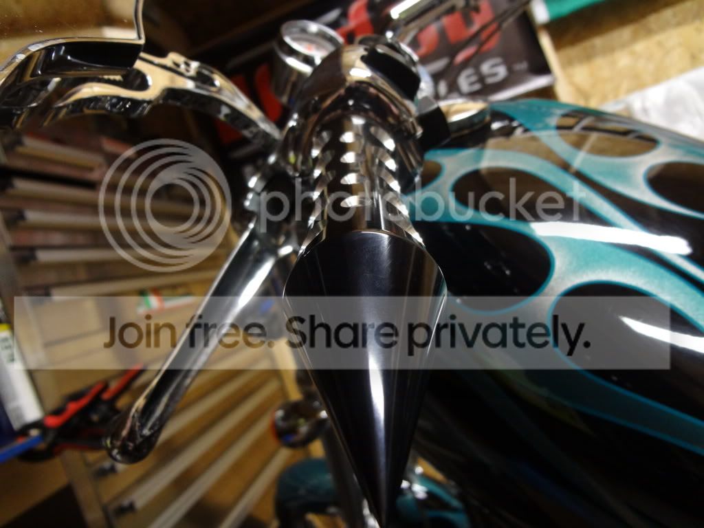

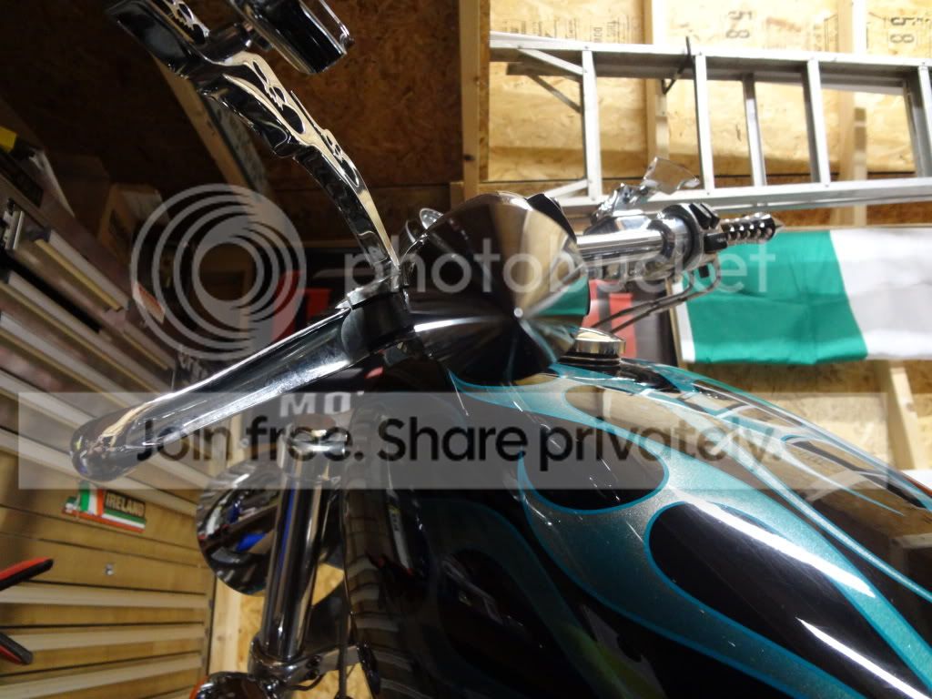

Pics of the Custom Chopperwerks fwd controls, pegs and grips

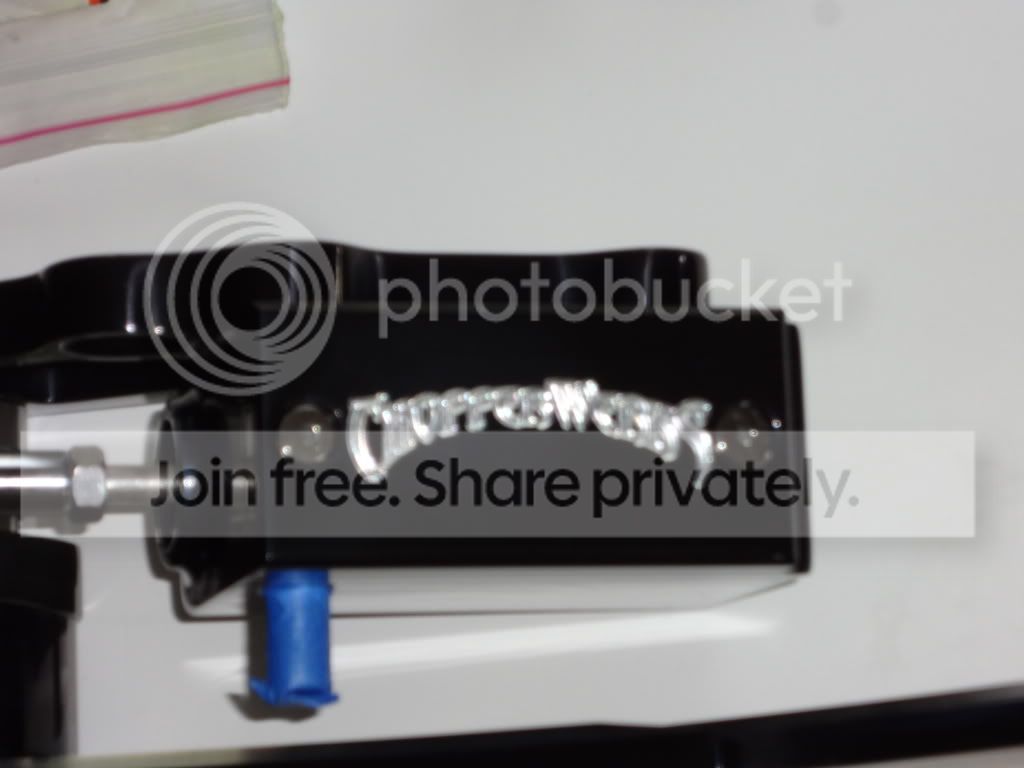

Thanks fellas! I have some issues with brake lights now. not sure if I broke the brake switch or not enough fluid is going through but I have no brake lights from front or rear brake
Oscar Maldonado
If all of the switches are in good condition then I would try rebleeding the system and try to get out of the lever and foot control all of the ply you might have.
It happened to me - I was running with a little play on my foot control so I rebled the whole system and have not had any problems. You also want to check and make sure that the brake switch/plunger isn't stuck on the brake housing. As far as the hnd control, Mine hasn't worked for years and my brakes are good. It all depends on the person I guess.
There is a thread here where someone is having an issue with the hand brake not working. Do a search and see if they resolved it and what the problem was.
Tattooedirish1
The Wicked Irishman
I'll try that

Hey jay, I have an 03 as well and had bought some balistini pegs that did not fit. Is there a certain part # you had to use since the chopper werks website does not specify big dogs? And do I have to buy the new clevis as well?

The 2003 and earlier bigdogs all use Harley parts. 84-99 softails for pegs grips hand controls etc. However on the RT frame I have the rear passenger pegs do not work the frame hole is larger than the threading in the Choppwerks clevis. Not to say other will not match.

When installed where the footpegs on foward controls from Chpperwerks lower than the factory big dog footpegs?

I dont know that they are lower than the stock pegs. If they are then not by much, but it is noticeably lower from my riding position. the pegs are a smaller outside diameter than stock so that my be the cause. The pegs are also longer than stock a will scrape the ground on tight turns while leaning the bike.
I did have to get a shorter linkage. Stock I believe was 15" where as my new one is 9 or 10" I believe some people were able to use the stock linkage. I believe Hollywood also has them. I believe he retained the stock linkage.
