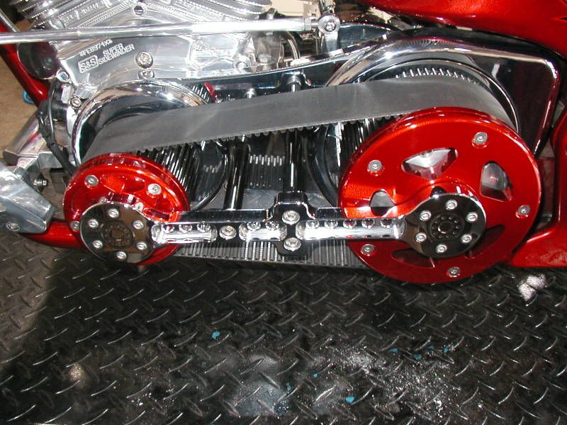

Showtime
I def would like to know who makes this belt drive.... Love my Karata but man o man this is a nice piece.....
