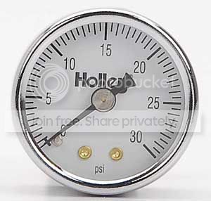

Never seen a gauge that does both, but I have the factory BDM temp dipstick gauge in mine and works pretty good. Oil never gets above 200 degrees. I actually used a White face Holley fuel pressure gauge for my oil pressure 0-30 PSI and love it.

Holley fuel gauge could you show a pic and where did you get it. Thanks

Excellent idea. I have been searching for a 0 to 30 gage

I wouldn't mind have a 0 to 30 psi gauge but it has to be liquid filled or it is going to fail real fast if not on the first ride. It has to be able to go slightly above 30 psi since I get about 30 psi on a cold startup. This is why a good digital would be the right choice for me.
