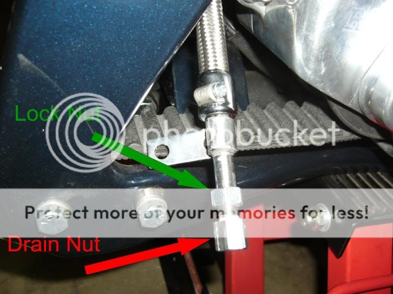

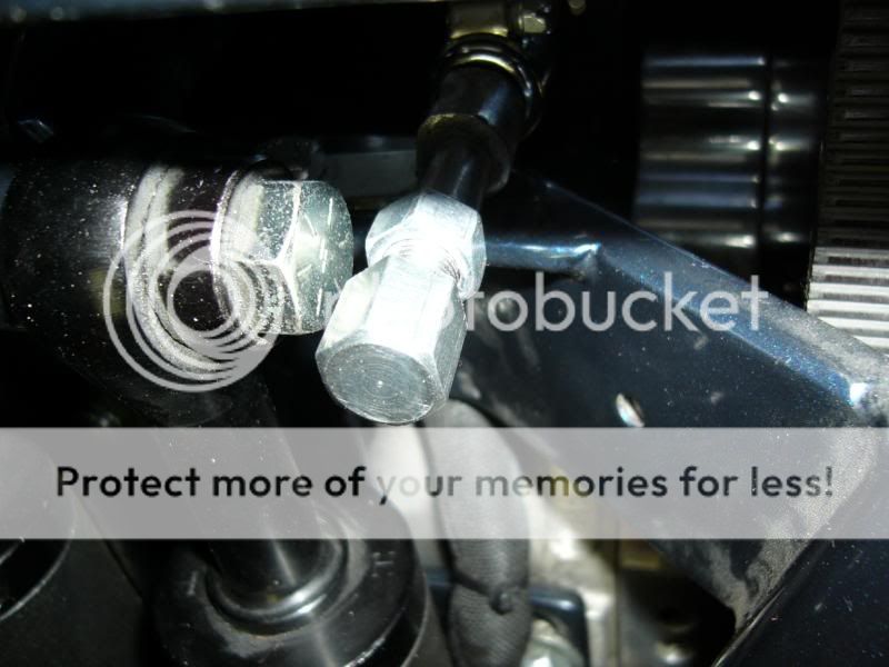

Donny - not sure if this applies to the 2003 models, but the 2004 Prostreets have the oil drain tube zip-tied to the frame. If that breaks loose (or someone forgets to zip-tie it down), it could come in contact with the rear drive belt and work a hole into the tube causing an oil leak -- this could explain what you saw.
Yep- this happened to me and was one of several reasons I do my own wrenching now....
CCRainman
I can bet that he has the same setup as us. Check your oil drain hose and plug. It runs down from your oil tank.
pig pen
Mine came with a rubber coated steal clamp that holds the oil dran hose. Its bolted to the frame cross member by the trans. No zip tie here.
chacha
Chaff Your EHC!!
Moespeeds wrote;
Mine is bolted down as well. Big Dog zip tied that thing???
Yep...that's what was on mine. Built a new oil drain and bolted it to the frame awhile back...
