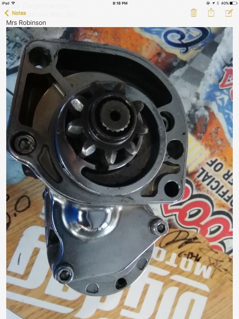

The starter nose should also have an oil relief groove in it to allow the oil to flow out of the pocket when its running, that was a modification they did in 05', the pic below is the relief, however this one is milled too deep, it should only be as deep as the bottom of the half moon pocket

Thanks a million for that pic- that's exactly what I needed. I just ordered a starter from shovelheadkicker on Ebay. I'm gonna put that in and make sure that primary vent isn't blocked and see if that takes care of it.

You can also modify a starter that isn't milled. No need to buy new.

Make sure you don't go as deep as the one I pictured :old2:

So did the new starter fix the problem? My original starter has the hole on the bottom just like the pic above this post..My new one doesn't and its leaking now...I am thinking of just buying a new one..wished Wild Steel Works was still fixing them..oh and I put a new bearing assembly with the new seal in it...it failed to..in the original one..

You can call Donna and Derek for a rebuilt starter with your's as an exchange, or send it to Dead One Customs for a rebuild of yours
