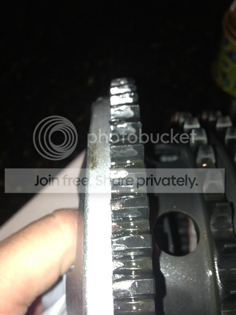

I also checked the main shaft and it will not budge, it has no play in it at all
The teeth of the gear show some uneven wear on it.

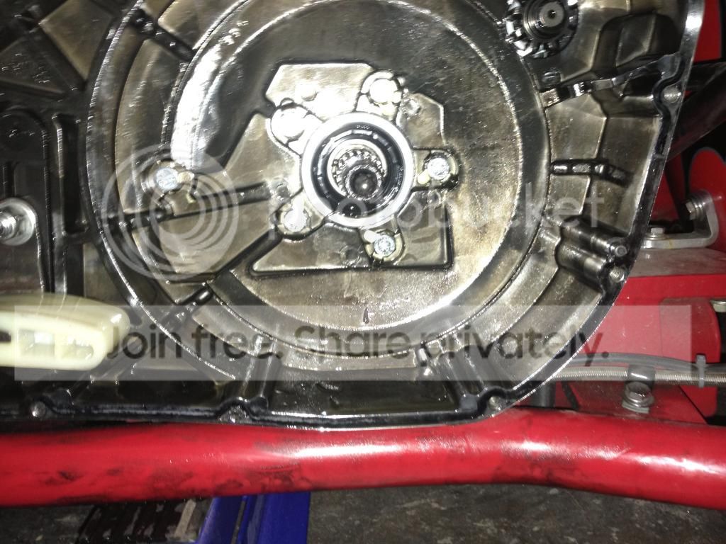

Here are two videos of the inner hub play on the bike. Does it appear to y'all that the inner hub maybe is worn out/bent and that is causing the problem? I can rotate the carrier almost a full tooth on the mainshaft before it turns the main shaft.
cmalin
Alright guys, I think I may have found the problem. The 4 allen head bolts that bolt into the flange, 1 off them was broke about half way into the threads. I did not notice it until I went to reassemble everything and I looked at the bolts. it appears that the bolts started to maybe back their way out of there and the one bolt snapped when I hit the pothole.

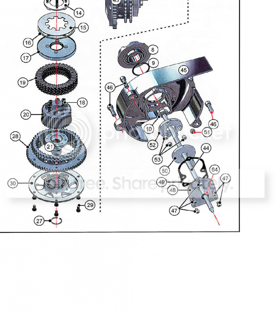

with all of that being said, I believe I will need a new inner flange and the 4 allen head bolts. So who has one that is reasonably priced?
cmalin
I need part 21 and the bolts which I believe is number 18
not too sure how the bolt got broken off in the hub but at this point I think starting fresh would be the best way to go rather than try and use a easy out on it, since I already had a alignment issue
