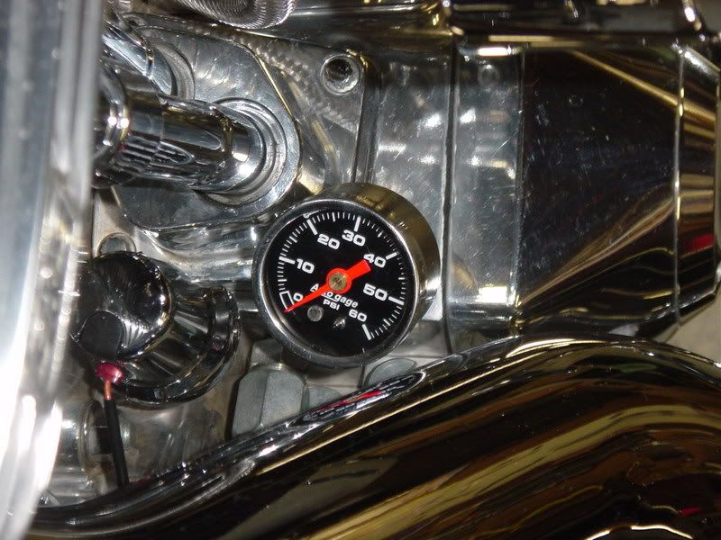

You be right!! Fl, it gets low its hot so get moving or shut it off!!! load very wise dude!!!! Florida sucks the life out of the dog!cold start dino 50 psi+ , engine hot your area dino, idle. 15 to 20psi. at 2000 rpm 35psi, [dino]
syn. 50 .cold, engine hot 15 to 18 psi, stop and go traffic, as low as 7 to 10 psi [your area, ] some were like florida as low as 3 psi,
bikes in florida need an oil cooler, summer thay should have two!!!!!!!!!
like the sender cover!
i am looking at putting two big dog coolers up front where stash tube goes,You be right!! Fl, it gets low its hot so get moving or shut it off!!! load very wise dude!!!! Florida sucks the life out of the dog!![]()
thats what I forgot to order Gas...that gauge and fittings.....looks like I will do that ......05.. read about it in my oil gauge thread
