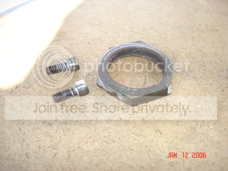

I had an issue with mine where the pulley nut backed off. Only reason I knew it happened was cause everyday when I backed it out of the garage it made a rubbing sound. Didn't here it going forward. Took it to the shop and the lock bolts to the pulley had worn and the nut was backing off causing the pulley to walk on the shaft.
I'll find the picture and post it here.
On my 05 the pulley nut is locked in by two bolts. Mine wore probably from a loose nut and finally worked there way loose.
