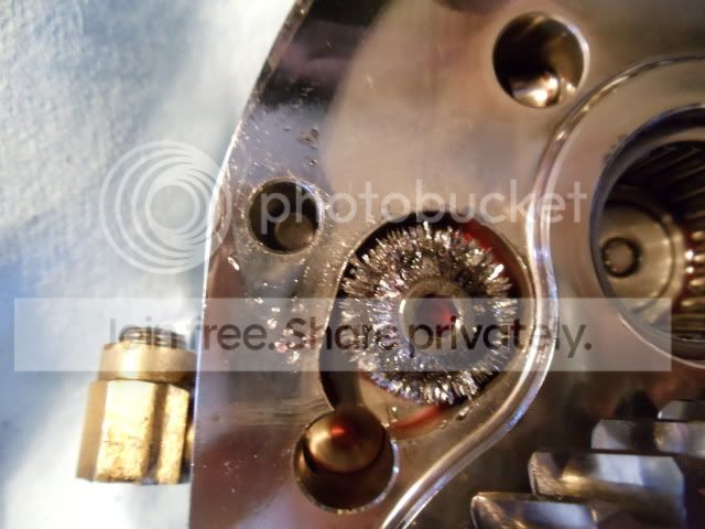

When I looked at the bearings currently in my transmission, I found that I have the following and noticed that the INA was stamped "JAPAN" and this is the left main bearing that had play.
Left Main Bearing- INA 3205J Made in Japan
Left Counter Bearing- FAG 6304 Made in Korea
Right Main Bearing - FAG 6209 Made in Korea
