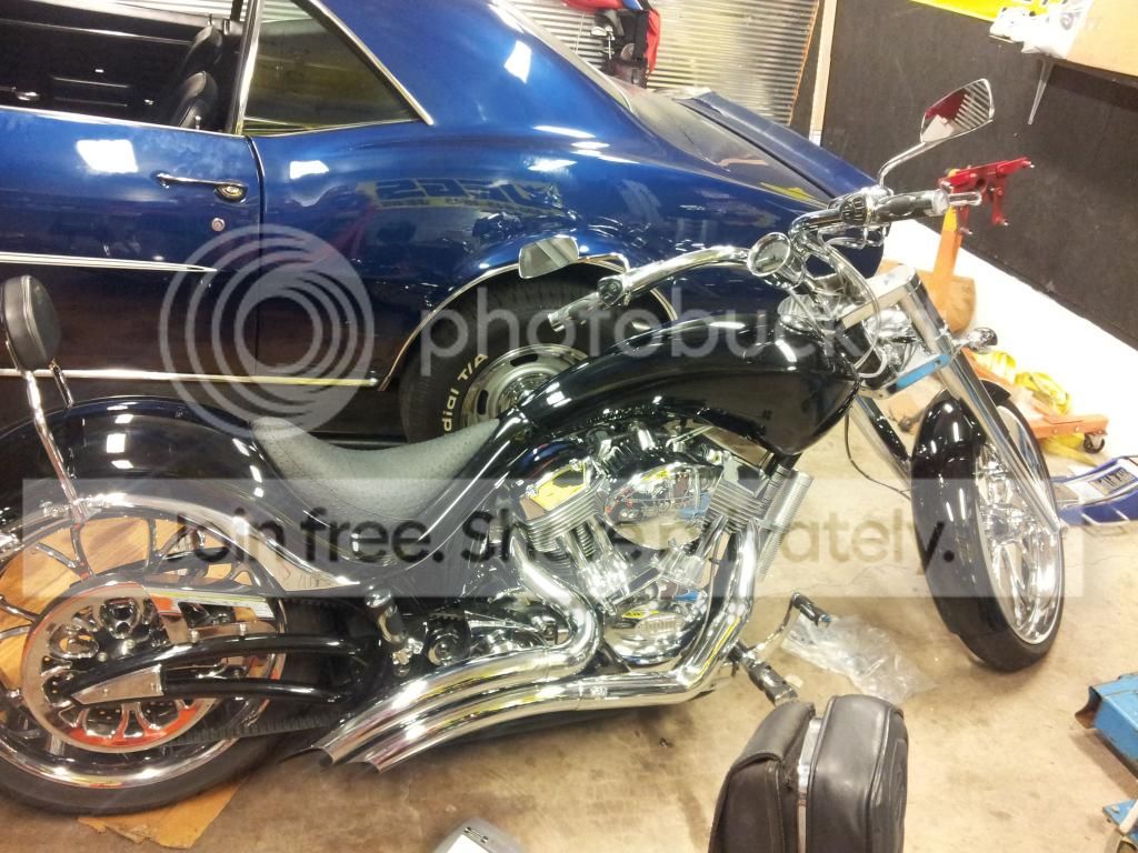

I Have not been on the Forum for a while after selling my 06 bulldog.went to
rmyrtle beach for the fall rally.went to the harley shop to get a t shirt for my boy.while I was there I checked out the bikes.they had taken in a Wolf on tarde for a street glide.after a couple of hours of we cant sell the bike for what you are offering I climbed the chain of command and scored the bike.I even left my number and Drive off at one point when we were 200 apart.as much as i liked the bulldog the Wolf is better.just when I was out the Wolf pulled me back in.

That is a beautiful bike. We looked at it Yesterday morning. Congrats and glad it found a good home. :2thumbs:
