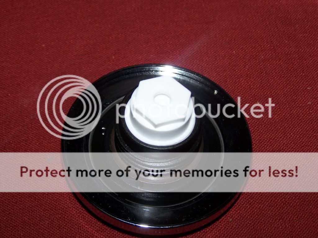

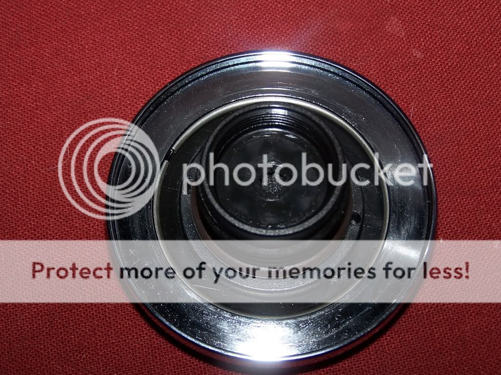

" Here are some pics of the new gas cap the dealer gave me. After taking off the white Nut piece, It still does not look the same as the pics Gas posted as to what it should look like. Am I missing something or is that all I need to do? It is the rachet style cap. The black cylinder part that threads into the tank rachets when tightened down, is it suppose to do that ? Thanks"
YES!!! The new caps DO ratchet. They are supposed to have a NEW paint saver as well, smaller in diameter - one that does not actually touch the tank. The gas cap fits just over the paint saver. The ratchet effect ensures no over tightening of the cap and in turn prevents the cap from touching the paint. (With the gas cap on there is a small hair-line space/gap between the cap and tank)
