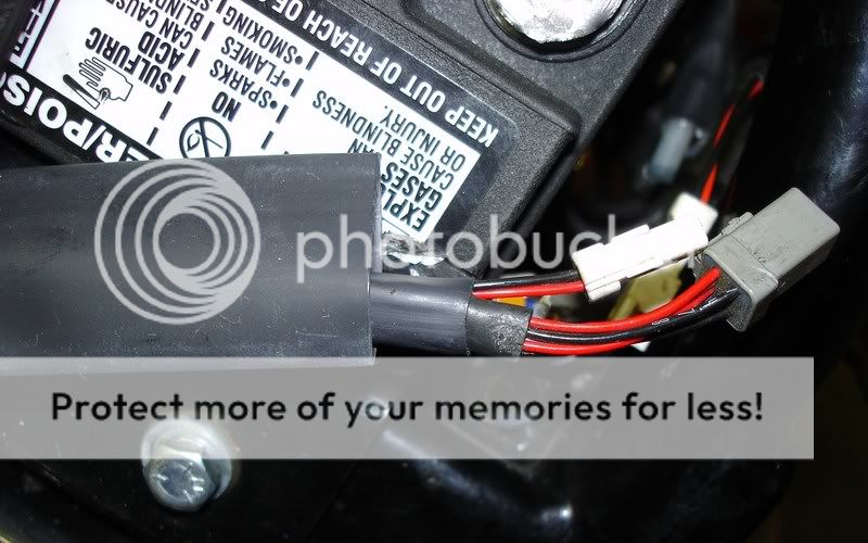

Here is the Ignition wires that have three connectors. I filled each connector with die-electric grease then shrunk wrapped them for a tight seal. These wires run along the front and bottom of the battery box on the 05 Chopper.

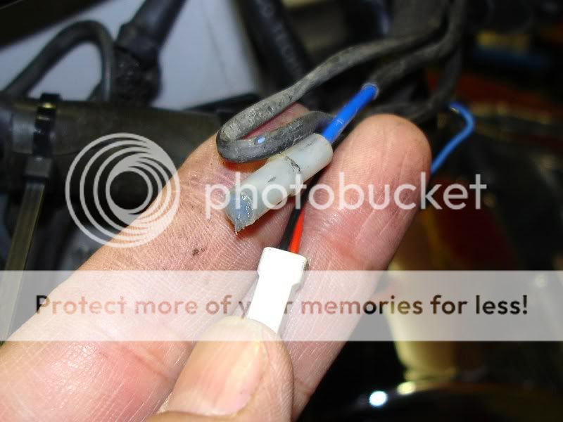

My neutral light has always given me problems so I took the weird plug and on the terminal side filled it with die-electric grease and on the EXPOSED back side I filled it with RTV.
