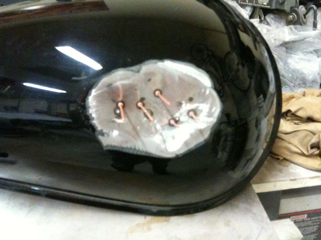

I'm trying to fix this dent without any welding.... any ideas.?

I already tried that..... and stopped. I was having too much fun pulling on it............. lolI think you need a bigger dildo than this for that dent...
..thanks knot; appreciate it. You don't still have that cap do you.? If so, maybe I can 'borrow' it, or buy it.?Well dont know if this will help you or not....before this idea i giving you its best to clean the tank properly...but i have taken a old fuel cap and welded a air hose fitting on it and hooked a valve onto it so i could control the air...took the petcock out and put a cap fitting on the tank....heated the dented area with a heat gun from a distance so not to damage the paint, in some cases it didnt matter cause paint was already screwed, and once i started getting it a little warm i would start putting air in the tank....less heat the better in some case...ive had good success with this if the tank hasnt got a crease from the accident
Sorry i hadnt got back to ya sooner...i will have to look but i think i loaned it out and never got it back but let me look...with that being said u got to be careful doing this cause u can blow the tank up with to much air....there is a fine line to pressurizing a thin wall tank....thanks knot; appreciate it. You don't still have that cap do you.? If so, maybe I can 'borrow' it, or buy it.?
