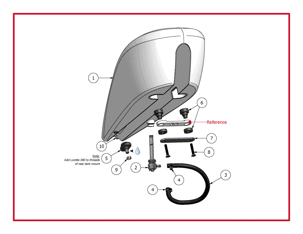

Looking for a Lower front tank mount for my 2006 k9. Maybe anyone who has changed tanks or did some special project might have one laying around. Listed as part #7 on Diagram. Its the bracket the 5/16 hex bolts go into,

I went threw this when I wanted to mount
BDM tank to my frame. Called BDM and Strokers - no luck there.
I went to the local metal shop called Metal Wharehouse.
They cut me a piece of 1 1/4 stock about 5 inches
then they drilled the two 3/4 inch holes for the rubber mount
I drilled the center 3/8 hole myself and rounded the ends around the 3/4
holes with a grinder. Had it powdercoated and it was done.
Was alittle work,took some time and effort .
