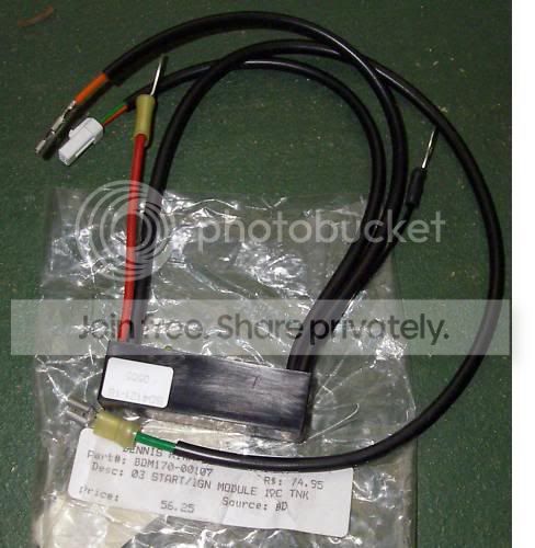

2004 Chopper, 10,004 miles. Bike cranked just fine yesterday in the garage. Cleaned her up right nice today for a ride in the sun. Cranked and started as usual, Fifteen seconds later it died like it ran out of gas. Cranked again and bike will not start. Pulled fuel line from carb (petcock off) and had fuel in the line. Opened petcock and fuel flows freely. Battery measures a good 12.98 vdc, starter cranks strong, seems like not spark. Just put plugs in couple 100 miles ago, changes plugs no go! Noticed that the ignition module red LED is not on nor do I see it flashing while cranking. NO fault lights on EHC. Yellow LED on EHC (power) flashes a nano second and goes out.
Do I have a ignition module, wiring or God forbid an EHC problem? Like to try to get her going before the upcoming long weekend, thanks fellas...
