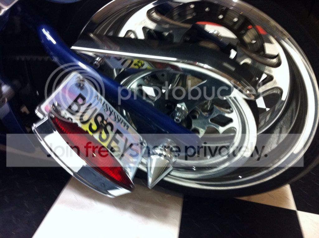

Here is what mine looks like now:

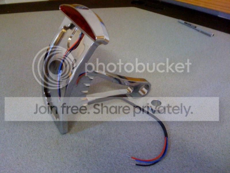

I would like to get something like this. I want vertical, curved, with brakelight:
I talked to the guy who works on my bike, he builds bikes in Mississippi, and he didn't like my idea. He said that the only way he would be comfortable mounting a bracket like that to the axle and they never stay tight. I thought it would just mount in hole on the current frame is mounted on.

First off, Id flip the plate around so the "Mississippi" is towards the tailight/plate light. To me it looks backwards. I personally wouldnt use an axel mount bracket. The curved bracket does look cool. I assume you already have the stock lights on the fender. I personally wouldnt put one down low(but thats your choice). I think a cleaner look would be mount a curved one with a plate light to your existing mount. On my new bike it had a horizontal mount. I drilled a few new holes and I was able to make it vertical. If you want to go the inexpensive route. Maybe you could make a bracket and mount it to your belt guard bolts.
C00lHandLuke
Thanks, to be honest I couldnt tell which way it should go. I'll turn it around. I'm not the most mechanically inclined person in the world, so I may be having a hard time following you. I'm pretty sure my mount and bracket is all one piece. On my swing arm is a tube or "hole" welded perpendicular to the frame. Then a long bolt is tightened through the bracket and the "mount" on the frame to keep it on. I was wondering if I could just take the current bracket off and mount the one in the second pic by doing the same thing, just run a bolt through the mounting hole on the new bracket and through the hole on the frame. The hole is about an inch wide and a bolt would have too much wiggle. Couldn't I fix that by getting bushing or something made to go through the hole on the frame, then run the bolt through them, then tighten them all together?
I'll try to get a pic of the underside part of the bracket so you can see it.

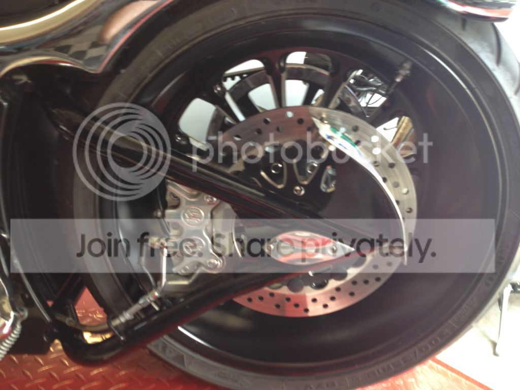

I cut out the stock mounting tab. The plate is 1/8 inch from the rotor. The inside edge is inline with outer edge of tire.

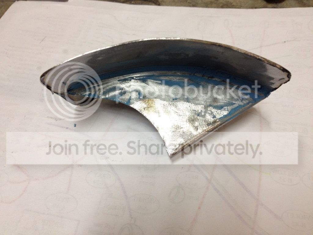

I fab'd up this temporary prototype out of shee metal. I will remake the "shark fin" potion out of 1"aluminum stock this winter. These were the in process pictures I have handy.
I drilled and tapped the swing arm to mount it.
Don't mind the giant bolt, it was just for mock up.

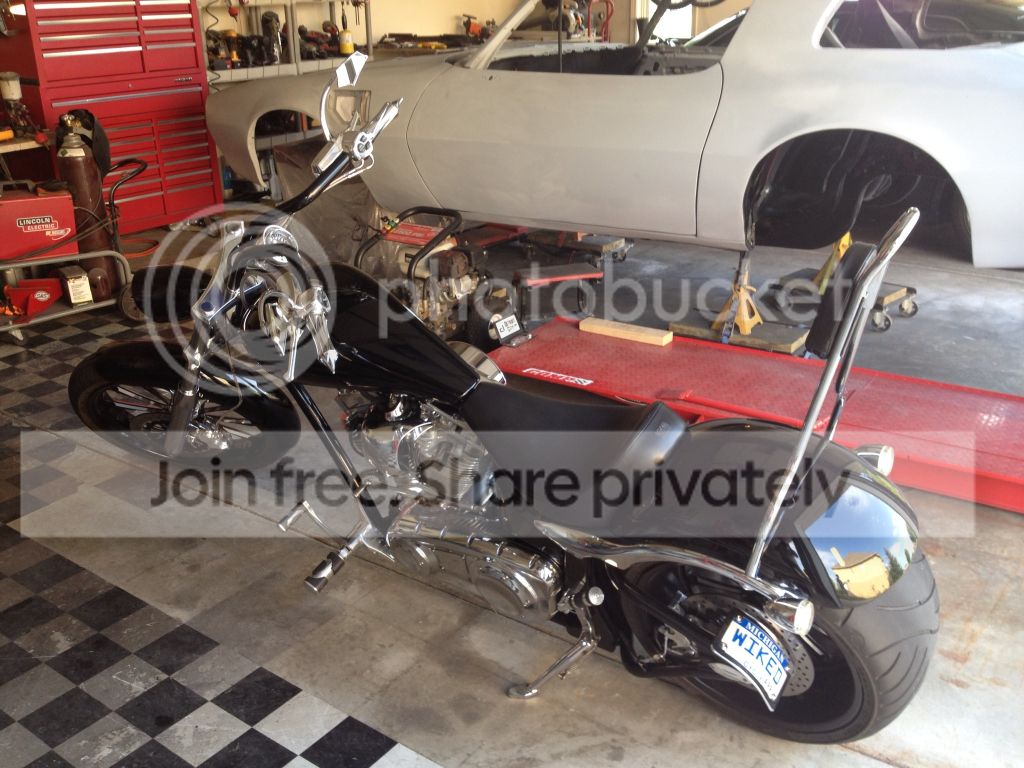

Not best pic of plate. I was taking to show the bike with new sissy bar. ( don't think I like it)
