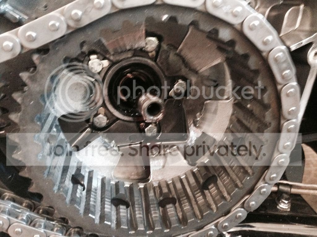

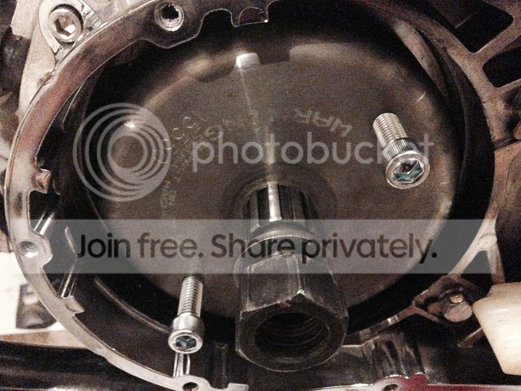

I had never had the clutch update done, this is what it looks like BLOWN UP!
After draining the primary and taking the cover off, First thing I did was take the 4 bolts out that hold the clutch basket spring and bearing in (check bearing to make sure it has about 1/16” play and rotates freely as well)…and I used a magnet to pull my clutch plates out one by one with spacers and keep them in order and then I really saw the basket Fucked and broken. keep your clutch plates in order and the spacers, from the back it is spacer, then clutch plate, then spacer etc….check your plates for damage or wear…..mine didn’t have a scratch on them…..

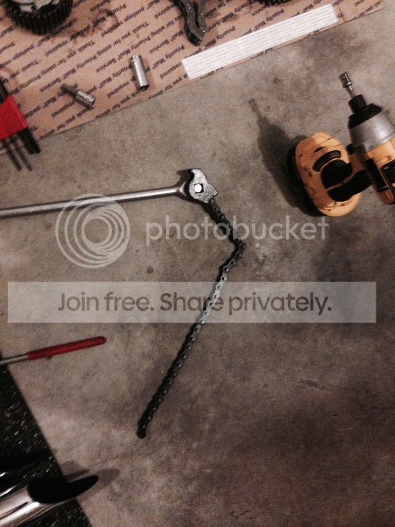

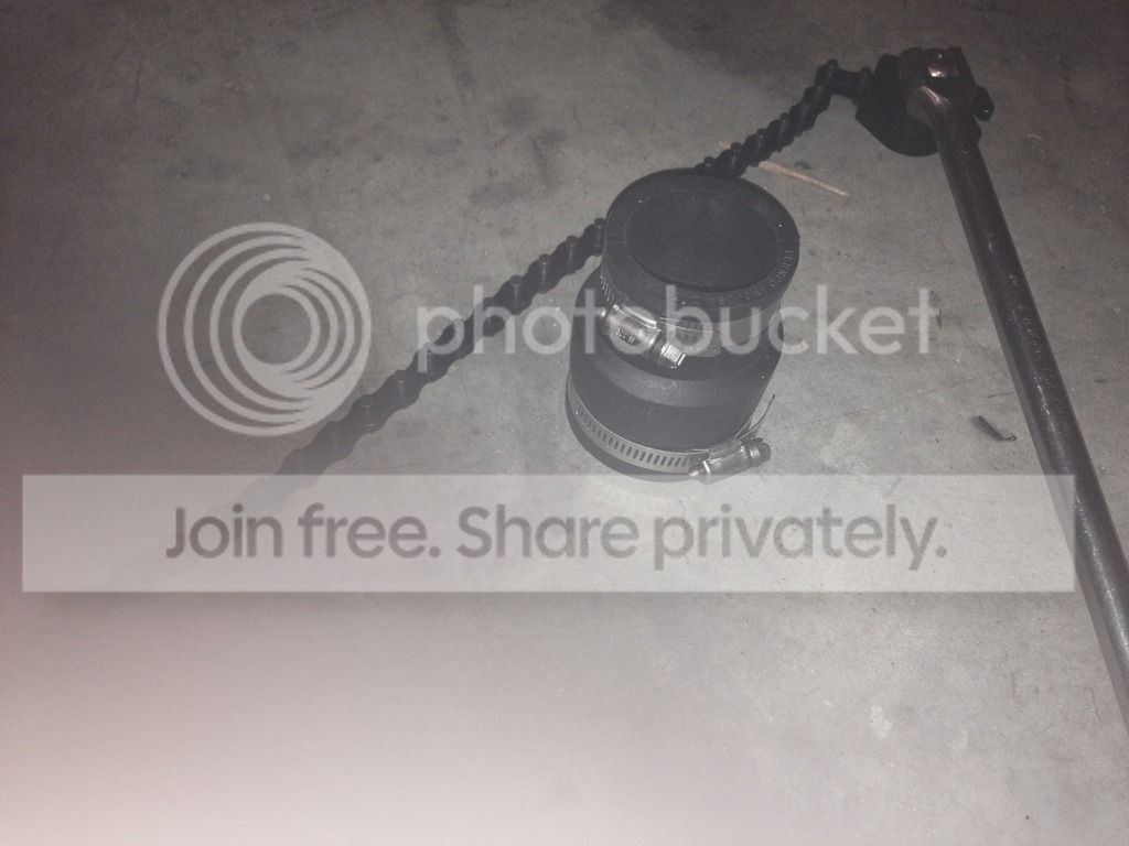

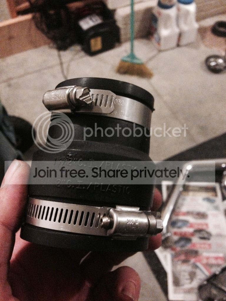

At that point, you can have one of your bigger neighbors come over and sit on the bike with the rear and front brake pulled while you loosen the clutch hub nut (lefty tighty, righty loosey), I’m a buck 65…..OR, use my PLUMBING chain wrench method…there are a lot of them out there, but a simple, cheap one is at harbour Freight….it’s called a 20” chain wrench and it’s $6.99. You can wrap it around, hold the gears with a breaker bar and the chain wrench locked around the sprocket, while you use an IMPACT gun to loosen the clutch hub nut. I used my dewalt cordless 300 foot/lb impact and it worked without a flaw. Using the chain wrench, my bike NEVER moved and I didn’t need any help, just make sure you put it on the right way so your sprockets don’t slip.
At that point I had NOT pulled my motor nut yet, since my basket was destroyed and pulled the whole clutch assembly out, chain included. Then, I used my Chain Wrench again to lock the motor gears down and loosen the motor nut with my impact (righty tighty, lefty loosey). I did this, because, you will NOT be able to put both sprockets back on with the chain without slipping both engine and clutch sprockets back on at the same time. UNLESS you take the chain tensioner out.

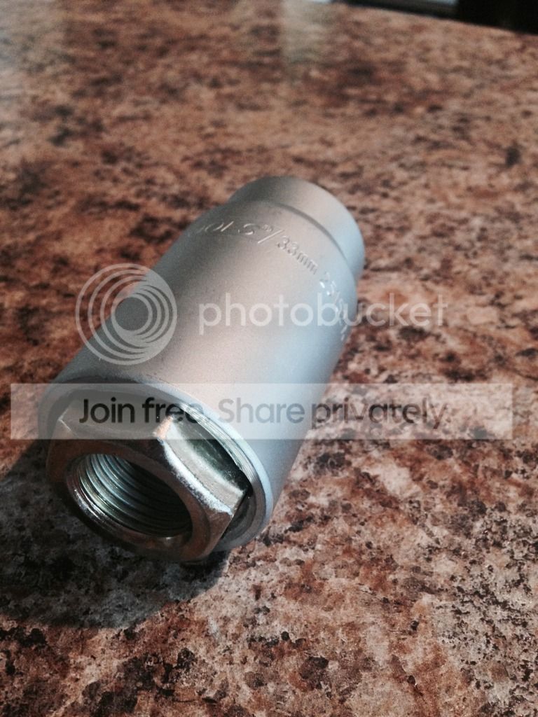

On a side note, my Motor Nut was a 33mm rather than a 1-5/16”, my 33mm fit tighter than my 1-5/16th…
33mm with Engine mount nut in it:

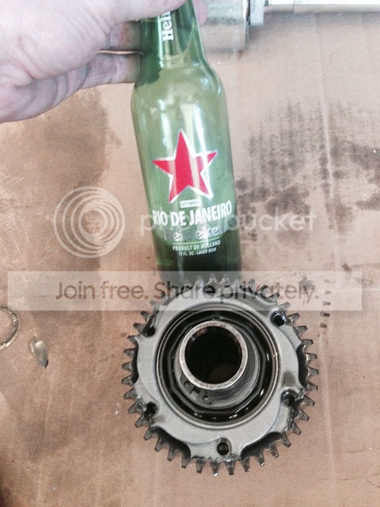

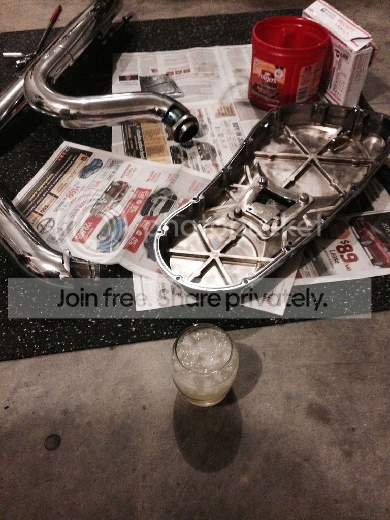

Then, sit back, have a margarita, or a heineken or dinner and a bottle of vino….and wait for parts….I ordered my complete BAKER clutch basket upgrade from Andrew, Curtis has them as well…OR, if you do have a press, you can just order the BANDIT clutch basket and re-press your sprocket/bearings back into the new Bandit basket. The new, upgraded baker basket comes pre-assembled with everything ready to go…since I’m lazy, that’s what I did.

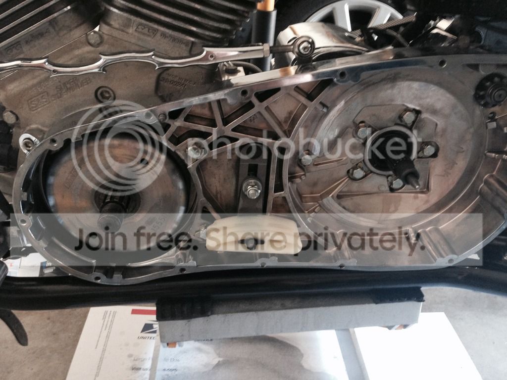

Clean primary waiting for parts
At this point, since you have everything apart, DRAIN your Transmission and take your exhaust off.… WHY? once the basket is out, it will leak most of your tranny fluid back out on your primary SIDE, don’t fill you trans again until the basket is back in and tightened down….or, it will leak out…..check your seal at that point as well to make sure it’s good.

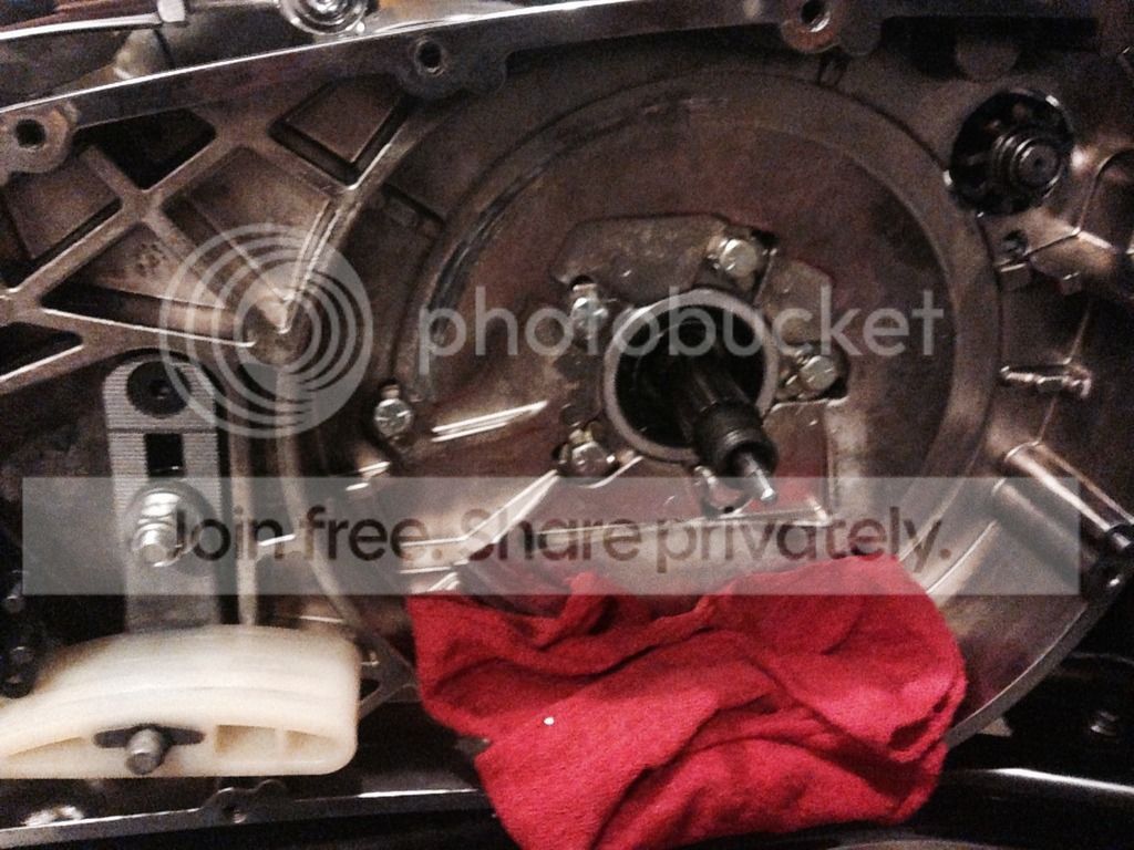

The ball and ramp if you take it off….loosen your clutch cable COMPLETELY….the ramp has to be all the way toward the back, offset from the front ramp (outside) before you put it back on. However, do NOT put it back onto the pushrod until your primary and clutch basket and motor sprocket and chain are back together and tightened down to specs. You can at this point also take it apart and clean it nicely (there is another DIY on there for doing that from GAS MAN on replacing your clutch cable, he included how to grease your pushrod as well as the R&R of the pushrod, ball n ramp and cable, you can find it in the link below). On a side note, those 5 screws that hold the ball n ramp together are SOFT metal, don’t impact them or over tighten, you will STRIP them…if you need the size for those 5 screws, they are 10-24, 3/8” length……yup, I stripped my bolts, had to cut a notch in them with a dremel to get them back out........lesson learned.....maybe...

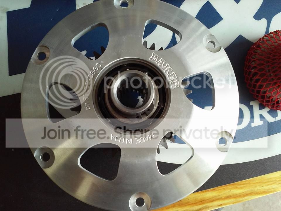

Here's a pic of the new upgraded Baker Basket I got from Andrew:

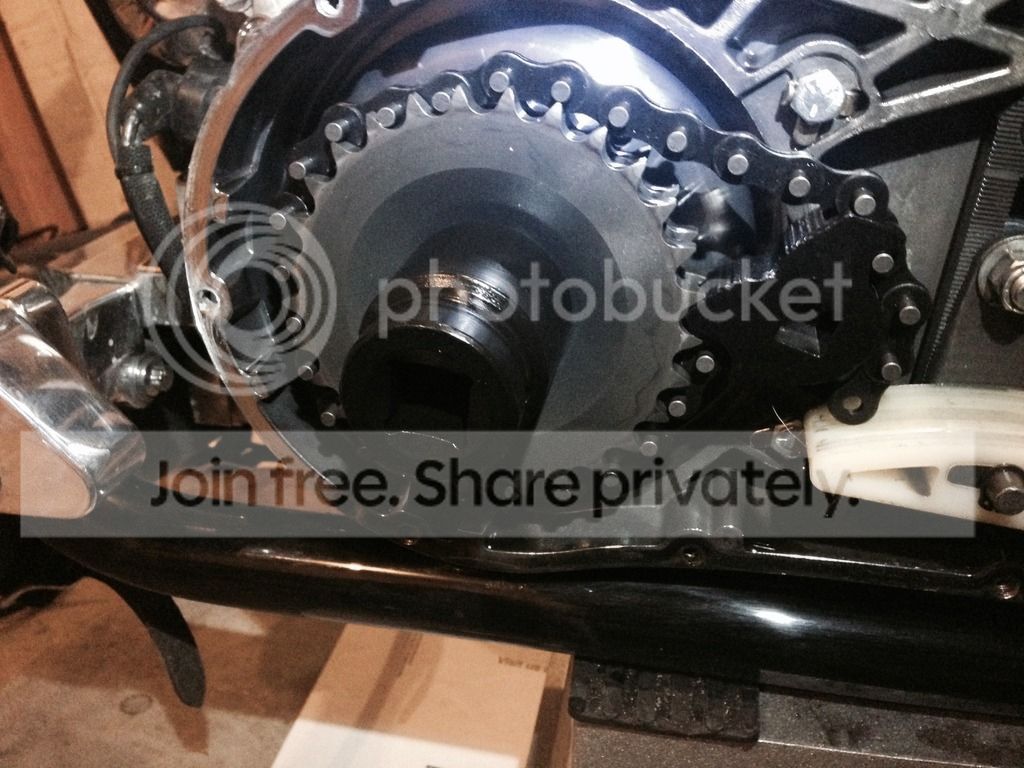

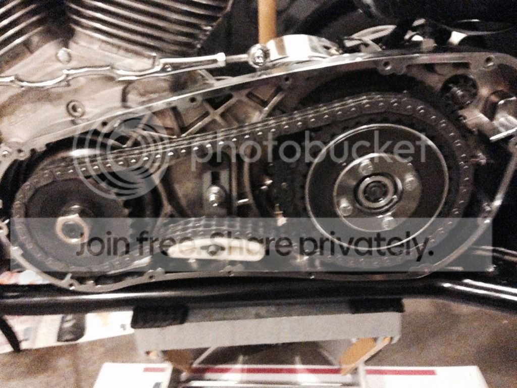

Completed re-install of new clutch basket with chain:
