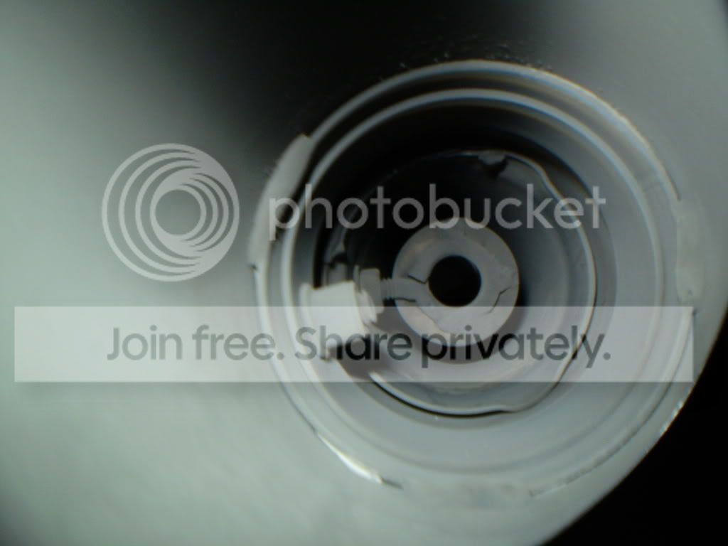

Nice washer baffle... I myself don't like baffles... :D
