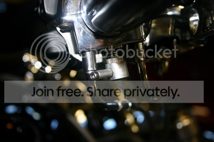

Cobrafast1
I made my own as a lever. Very easy to use and engage and disengage.
Here's a photo.
This slips right over the existing control knob.

Yea Cobra, I think I like yours better if the lever stuck out about another inch.
