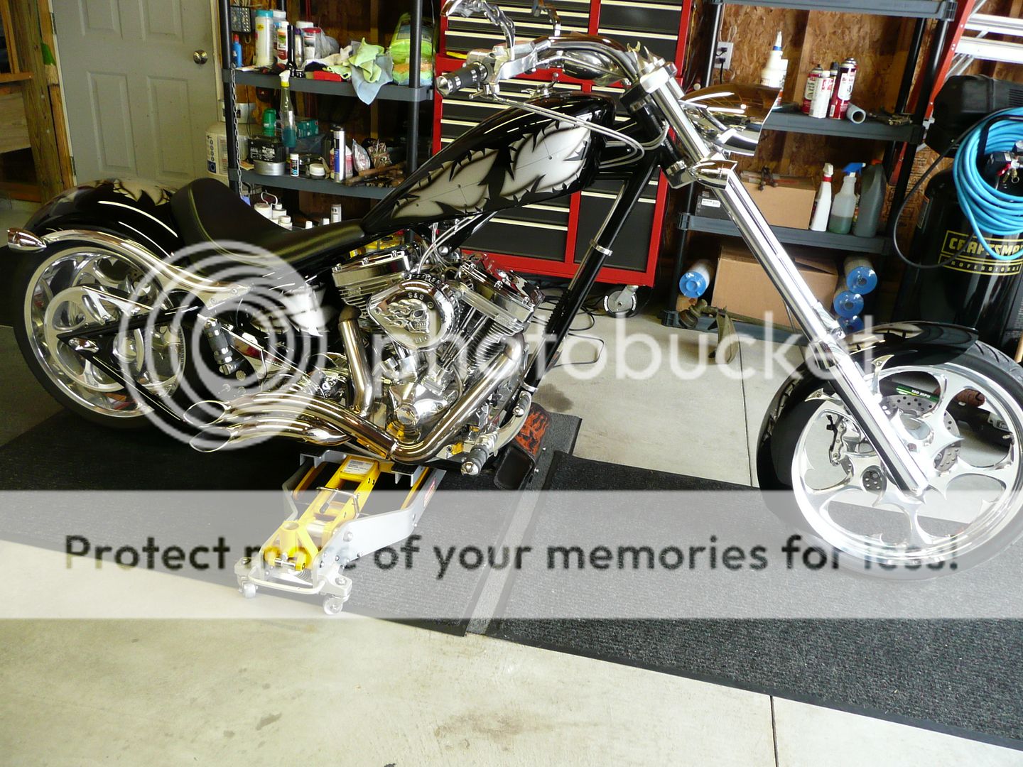

I have an 2003 chopper and this is how I use my yellow harbor freight jack/lift.
I get on the opposite side of the kickstand and position the jack where I want to slide it under. Next I grab the handlebars with my left hand and stand the BDM straight up while I slide the jack under with my right hand. Some times I have to rock the BDM a little to work the jack underneath, but it goes under pretty smoothly. Once I have the jack where I want it, I continue to hold the handlebars with my left hand until I pump the jack a couple of times to fully stablize the MC. From there I can lift it up and manuever it any way I need.
Now this may not work for the K9s or other models, but it works for me on my 2003 Chopper and I was told I may have to ride up on a piece of wood or something to get mine to work, but I didn't. I just thought I would throw this out here, for people who may benefit.
