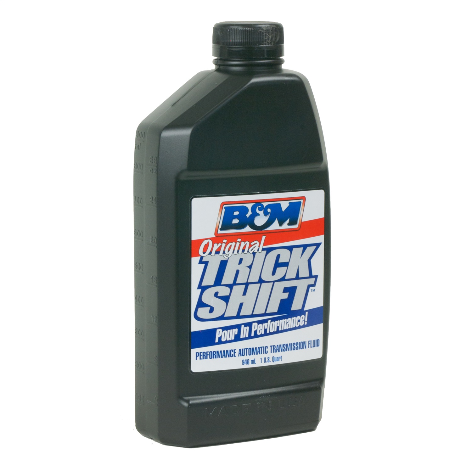

I have mine backed off less, 1/16 turn but I have the 12 disc with the soft pull ramp which was intended for the 9 disc clutch. Do you know what primary oil is in there? I run regular hardly primary oil in mine.
I use this and it works unbelievably well, be sure to get the non-synthetic!
PROFLYER
SWOLE
That's the stuff and made in the USA. How often can you say an oil is made in the USA?
Tip...You can get it for around $5 on Amazon
Yep, I've used TrickShift for years now. Cheap and works great. The ONLY purpose of anything in the primary is to lube the chain. That clutch can run dry or wet.
