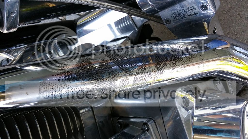

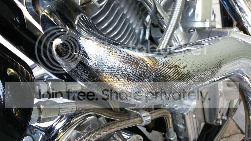

I took several pictures, but it's hard to photograph chrome. Mine aren't in as good of shape as I thought they were any how. How bad are your?

My heat shields are pretty grungy...I had a black plastic bag gust up as I drove by and it stuck right to the hot pipes. I reached down and pulled the bag off but what plastic that stuck to the pipes, seems to be "engrained" into the metal. I bet I have spent hours and a can of polish trying to get it back to chrome. I will try to get some pics also. Maybe your shields are in better shape... Thanks for the replies!

WD-40 and aluminum foil. Wad the foil in a ball and use it like a scrub brush. The foil is softer than the chrome so it won't scratch. If the don't work I'll trade you pieces.

Foil & WD40 did not work, gave it 45 minutes of constant rubbing and it showed close to no result.
I am thinking re-chrome or swapping them out is going to be only way to go, damn.

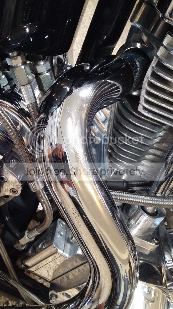

I've had good luck with oven cleaner I'll soak it on a rag and let it sit on the pipe for 5-10 minutes.
Sometimes I gotta use my fingernails ...it's a bitch

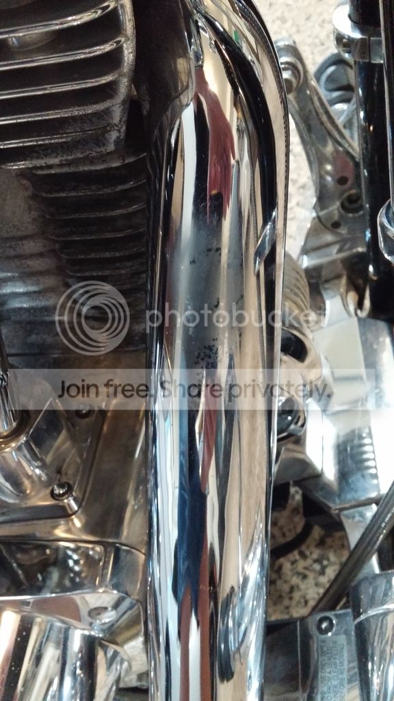

Tried the oven cleaner, it worked the best.
They are not perfect by any means, but better.

Glad it worked for ya looks much better! Pain in the ass though.
