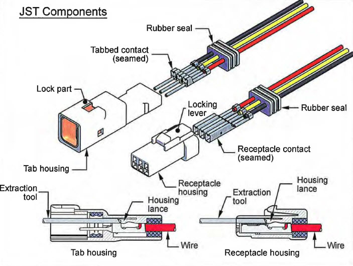

I bought this headlight from BDM before they went under because mine was scratched. I'm finally getting around to putting it on, but the plastic connector piece came separate. Can anyone tell me if I will need some kind of tool to properly install the wires, or if the just kinda "pop in"?

They do push in but make sure you have the colors matched and they are installed in the right orientation:
You may also need to use a small eyeglass flat head screwdriver to push them in until you hear a little "click" sound
