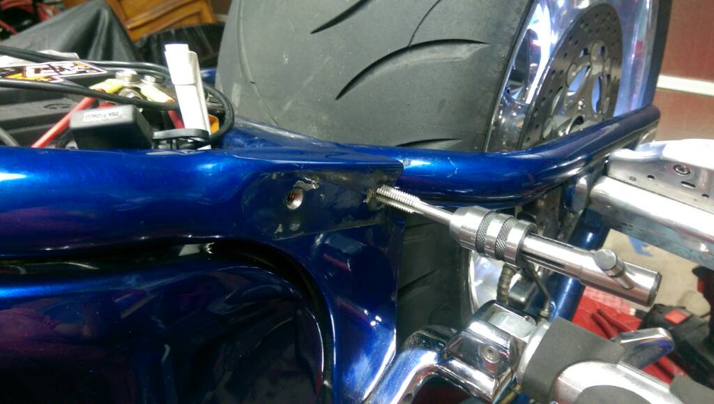

I'm with ya. Clutch started getting soft on me on my 100 mile ride yesterday since I'm meeting up down south here in a few weeks figured I'd double Check the hub nut. All good in the hood! Wasn't loose good peace of mind as I plan on putting at least 1500 miles on in 2 weeks.
Now I gotta put it all back together. Probably adjust the push rods too.
This is why God nvented Loctite!
Thought I did put it on there ! Whoops maybe not.
I think hardware store is closed today so bolt will have to wait till tomorrow. Although I bet I got one in the spare parts bin somewhere
Well would have been better if I didn't use loctite. Found a bolt in my parts bin but it won't screw in with the old one in there
Yahtzee ...nice when a shitty situation comes out okay.
I was able to weld a nut on and she came out took a couple tries to get it right but drilling that out I would have been here all night!, ran a tap down the holes and back together!
