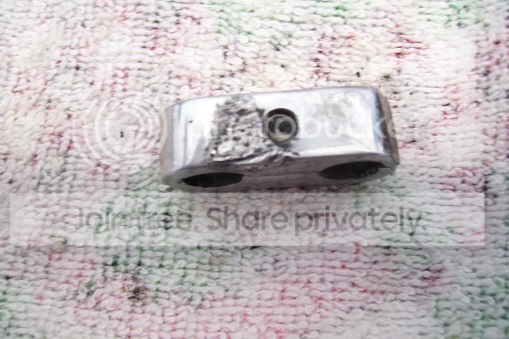

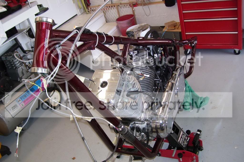

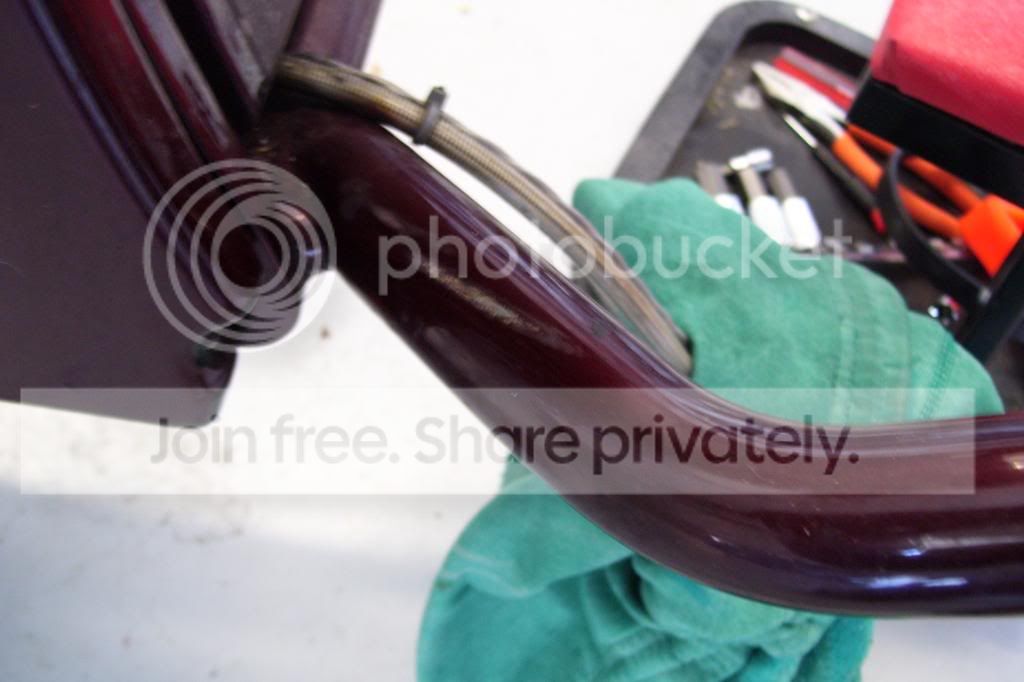

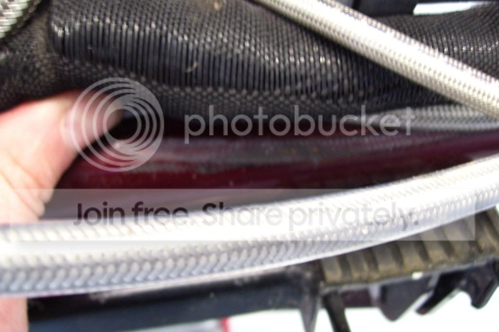

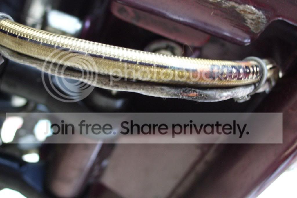

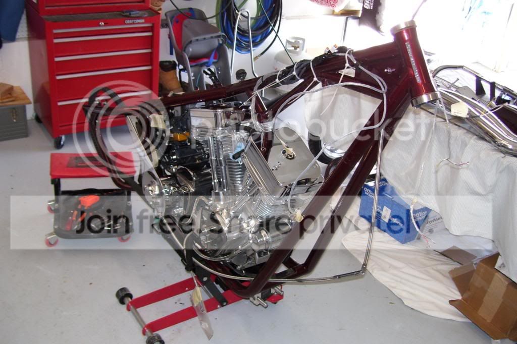

Removed the last of the billet today & here is what I am left with
After I got her stripped down, started inspecting and found wear any place anything touches the frame.

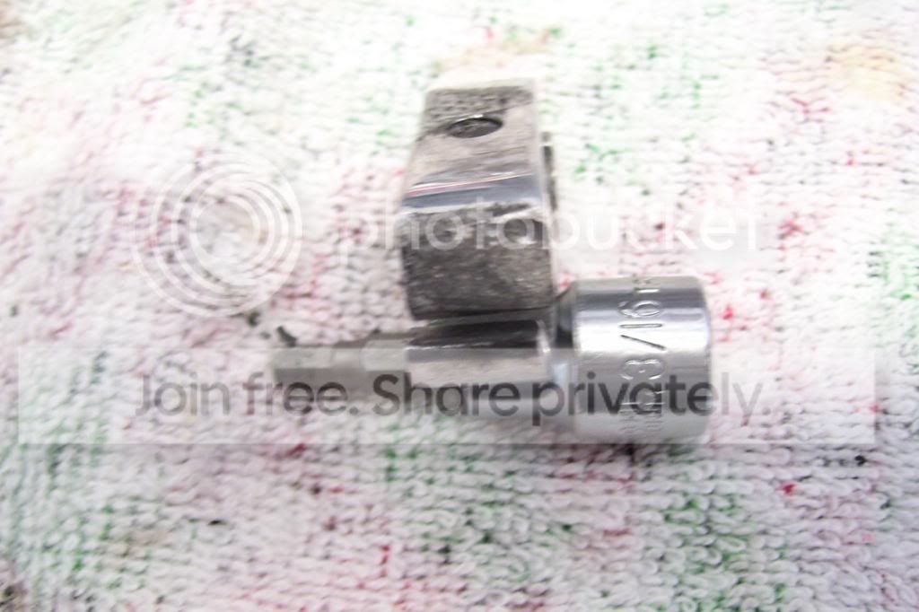

Look at the break line clamp adn the damage it has taken from vibration

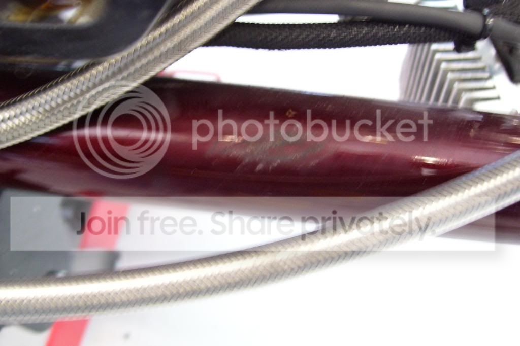

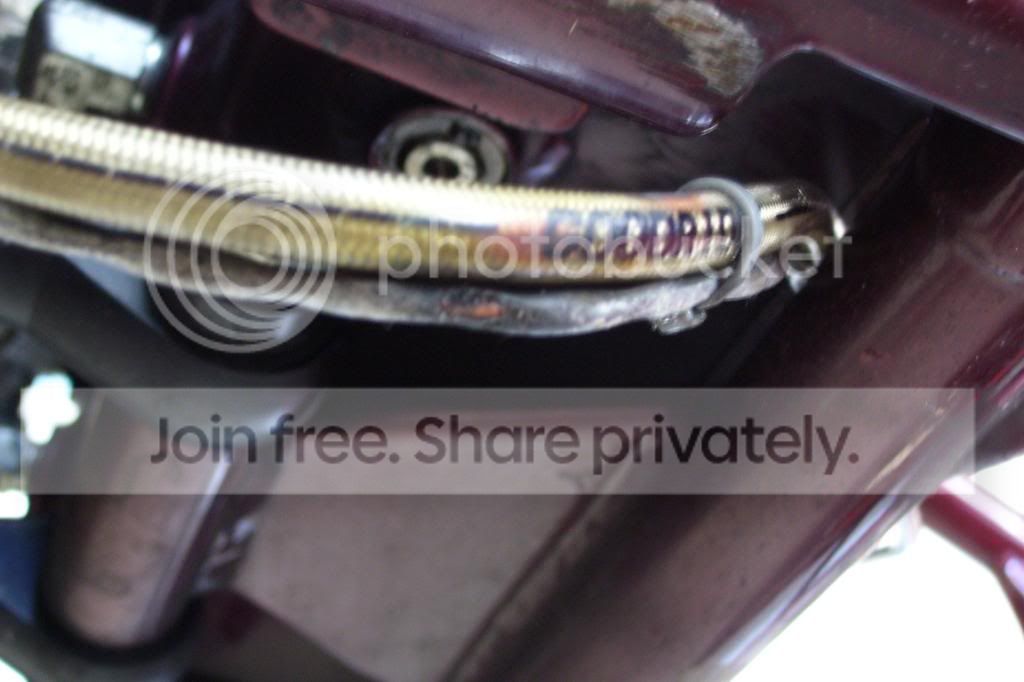

And the rear break wiring & lines

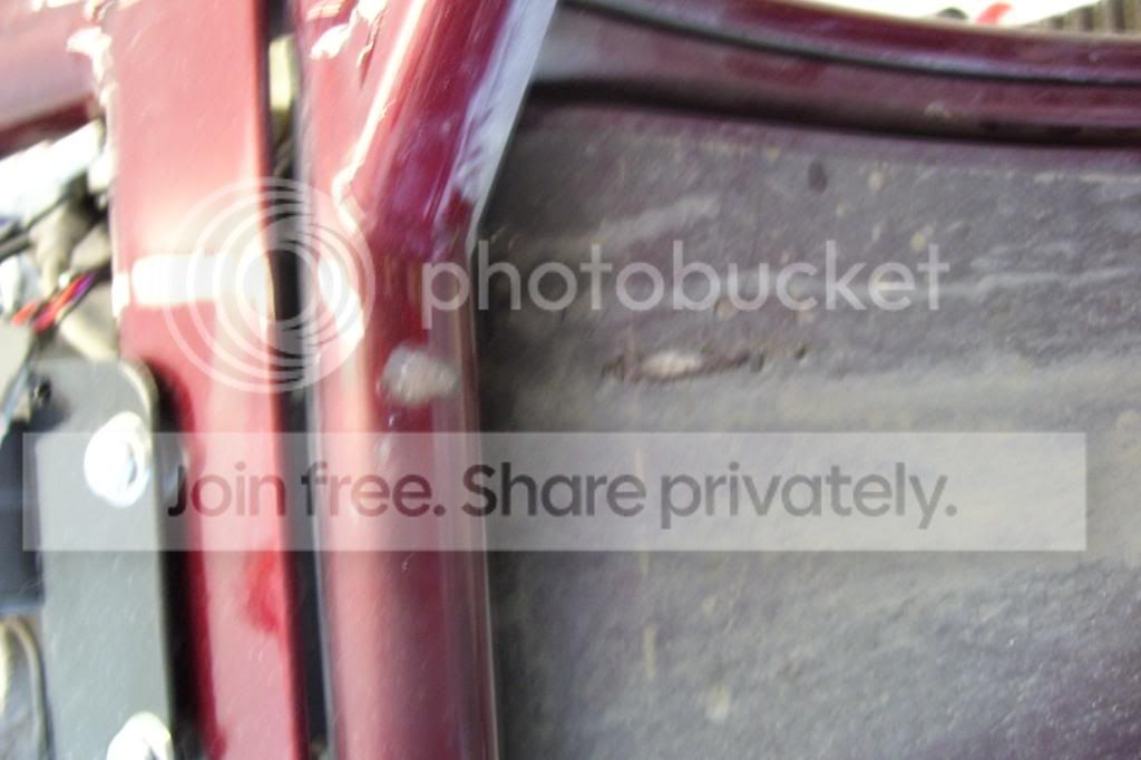

Also with the removal of the rear tire you can see where the spike I ran over in Custer State Park hit my oil tank & frame.
So inspect your dog! Avoid any wiring touching the frame unless it's secured tight if thats possible.

Gas is right, pulling the motor tranny adn battery box with all the wiring is a much bigger and more complicated task. I am just removing bolts and taking shit off.
For those of you that did Gas' how to on shrink wrapping your wires, on the right side of the bike down by the frame there are more connectors that can be shrink wrapped. At first I thought the black wrap that covers them was a tube cover, but it's not. You can unwrap those wires, check for wear, and shrink wrap the couple of connectors that are covered by the wrap. I would think these would be important since they are so close to the ground, and take heavy water in any sort of rain.
