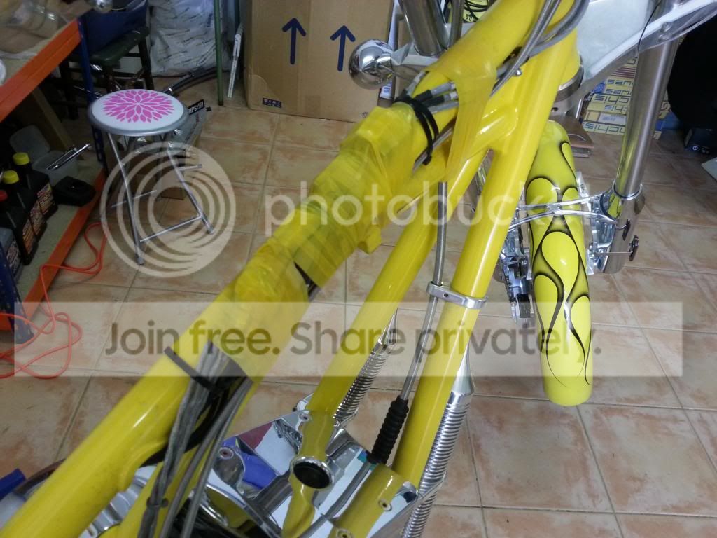

Ok, finally I have started the "operation"... I ve found some nasty surprises... lots of corrosion in some conections etc...
Here below some pics..

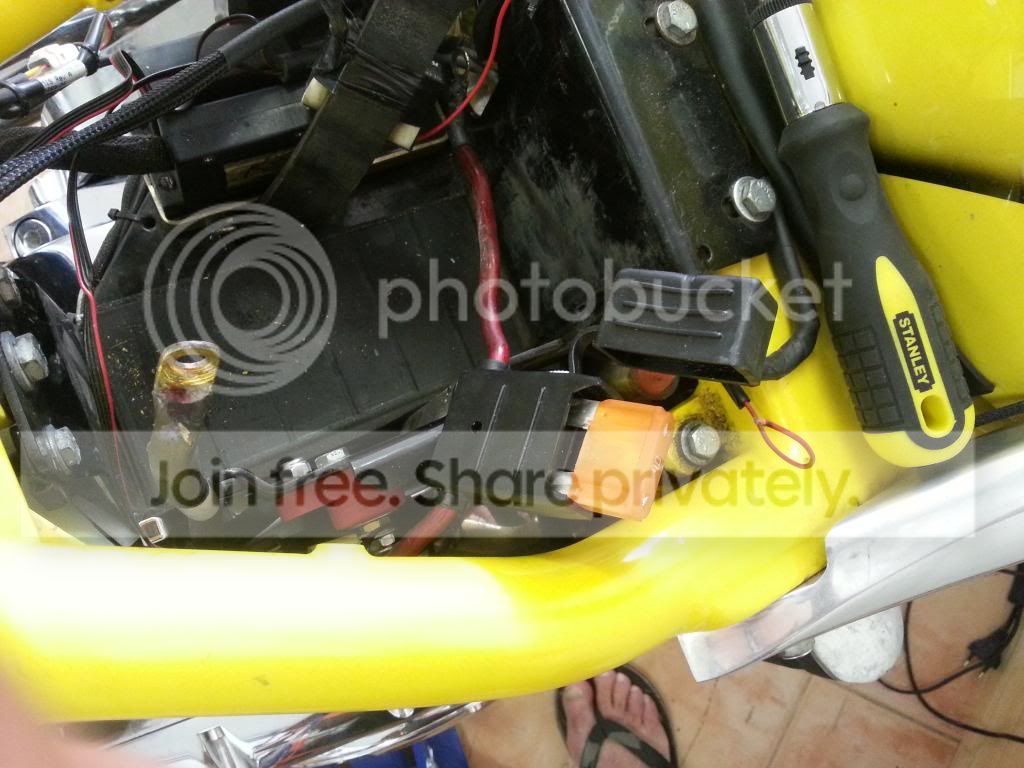

1. The Fuse; It was so corroded I dunno how the F the bike was running... I did clean it with sand paper and then fill it up with Dialectric Grease... Now. This Fuses are HUGE! I have never seen nothing like that in Europe... WHERE CAN I FIND A COUPLE SPARES?

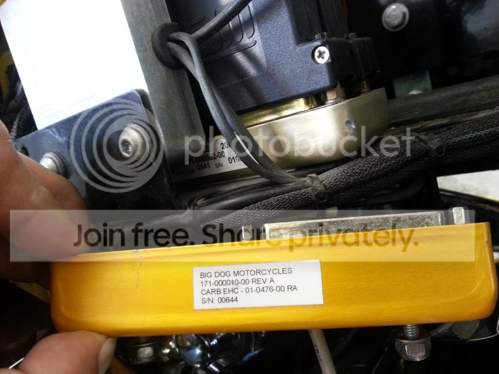

2. The EHC; As you can see in the pics... the one (original still mounted on the Dog) and the spare next to it, on my hand.... WOULD IT BE WORTH IT TO SWAP EM?
3. The TH Programmable Inginition; No problems here... it was sent to me by TH with the correct jacks :2thumbs:

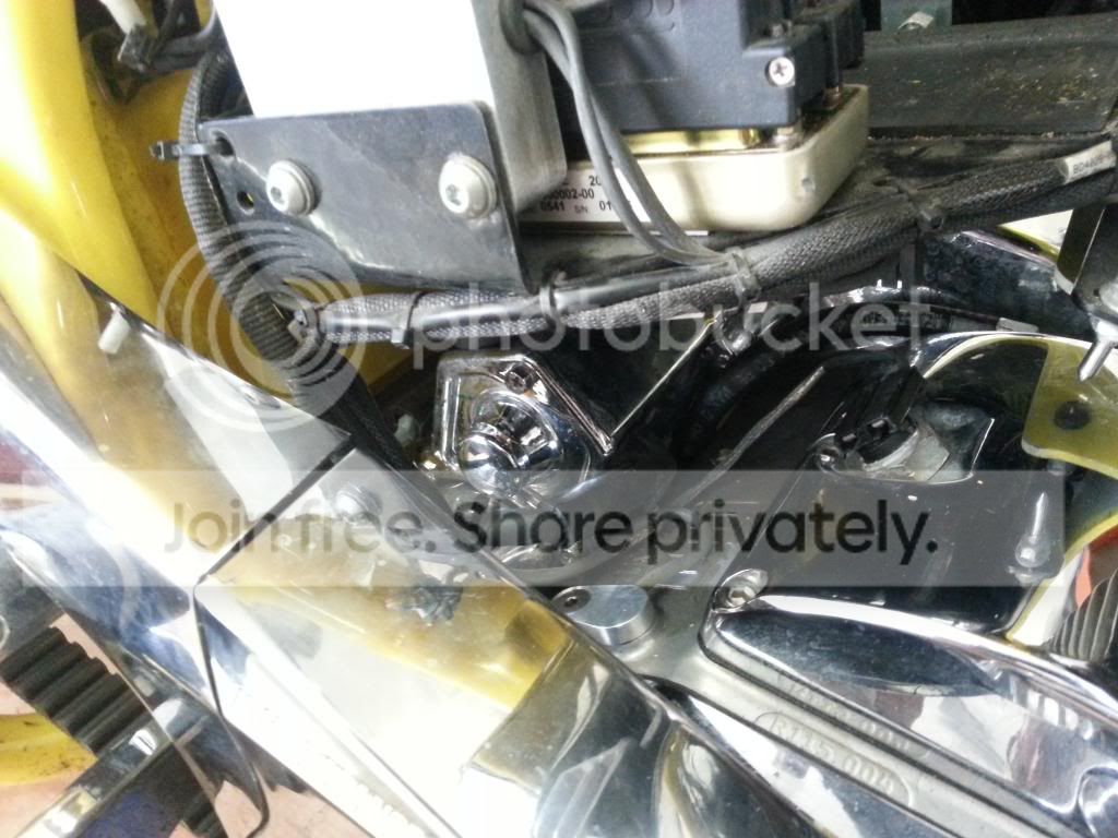

4. The Slam Button; I cannot reach to it :bang::bang: Tips?

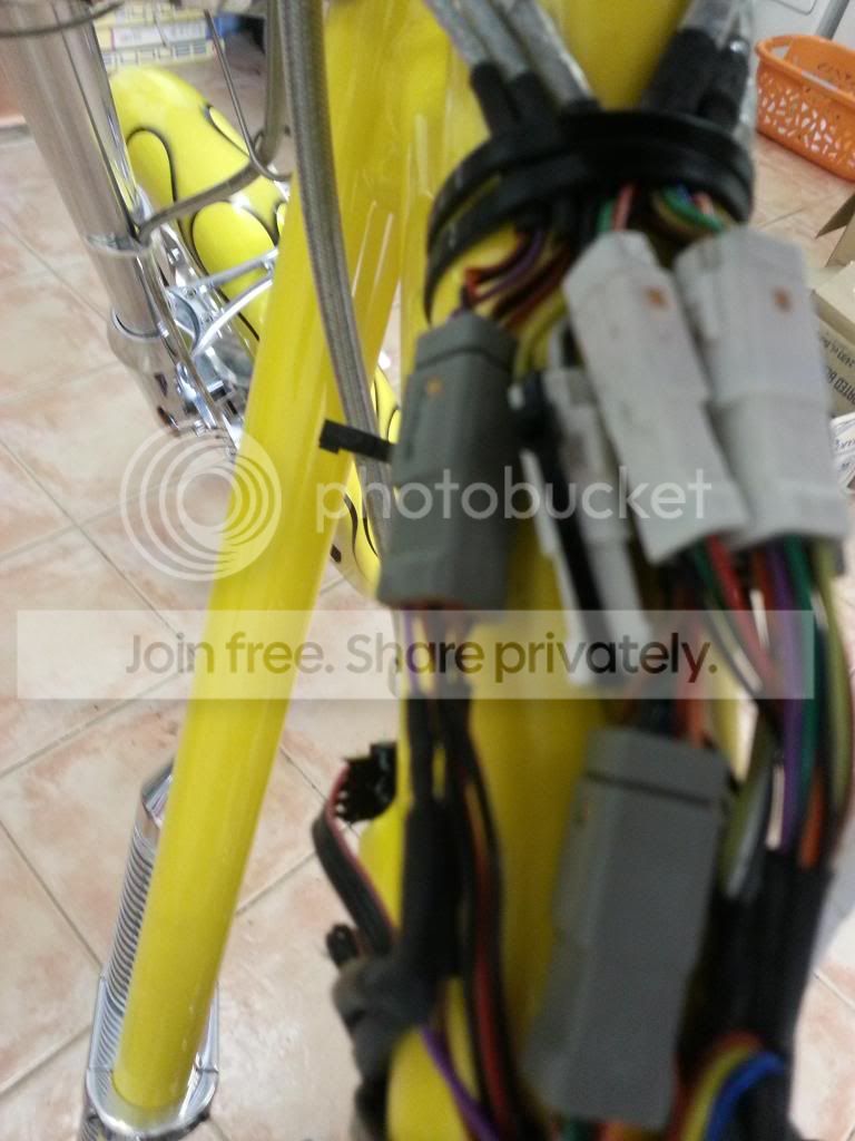

5. The rest of the pics are just routine maintenace... Dielectric Grease in all conectors, etc (some were holding by zip ties :eek:)
To be continued.... Thanks guys.
paleskin
Franco,
The fuse on your bike is older than the one on my bike and they are different, but I did just order some that I found online. If they were the same I would just send it to you. As for the slam button, the easiest way I found is to get the 1/4 inch rachet with the extension and a swivel piece then the socket that fits and remove the bolts. Initially I tried to use the screw driver but ultimately just couldnt get that to work. With the extension and swivel you can approach through the belt gaurd. Also you should take off the plastic baattery covers if you can so as to have a better field of vision and avoid damaging them. Can't adviswe on the EHC swap other than to say "if it ain't broke...."
bigdogtech01
It's called a MAXI fuse...I have probably 20 or so of them kits with the fuse on hand if you need one...as far as just getting a fuse, most auto parts stores have them here in the states...if you need one or more and want me to send them your way, let me know :cheers:

Paleskin: Rgr that... a swivel extension is what I need, I tried to remove the belt guard but the inside screw is giving me a hard time :bang:
I have cleaned & greased up the conections and hokked up the same old EHC .... also I have changed the Ignition module, now I have the Programable one :D

Andrew: yes Bro, I think it is still OK but I wouldnt mind to have some spare ones, just in case! :D I will PM you.

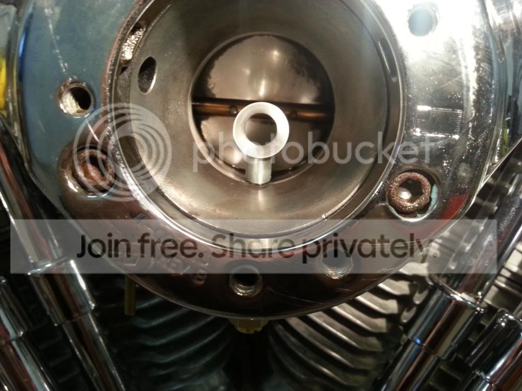

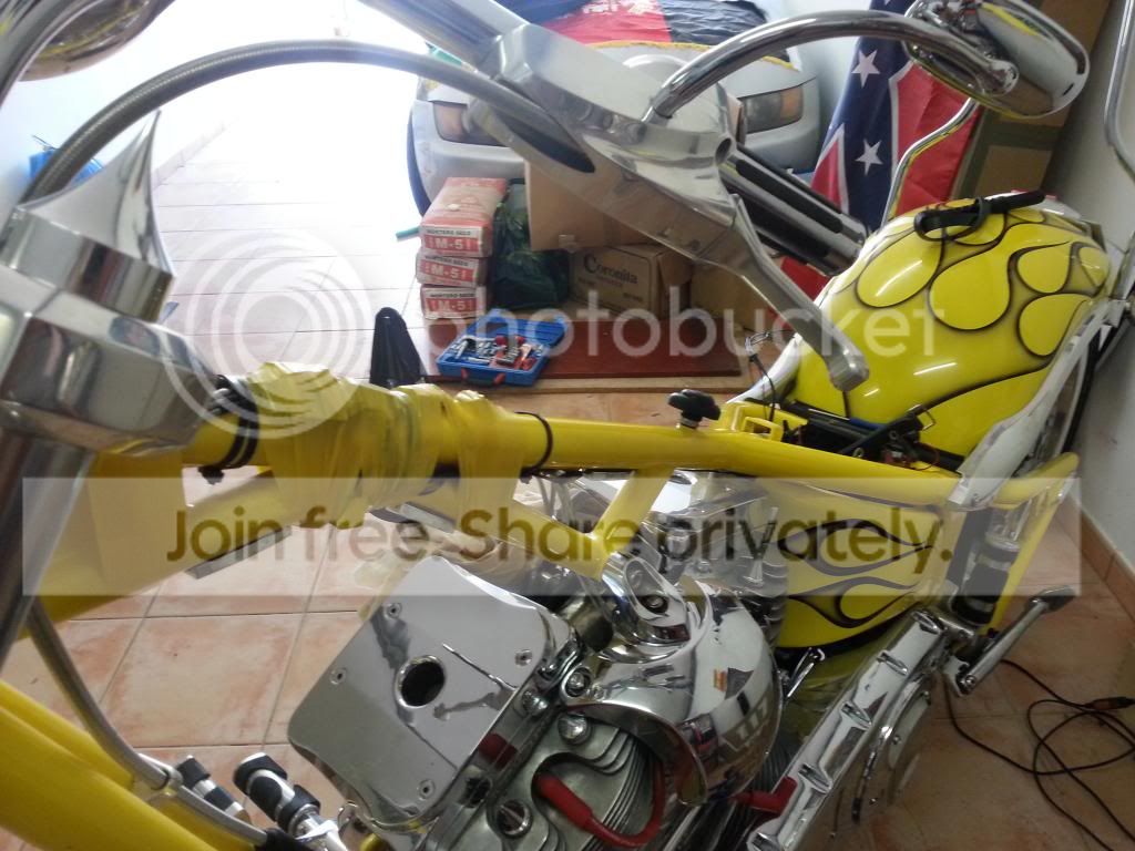

Alright.... one more question.... I have been installing the xXx Booster kit........ I am not happy the way ended up... see pic below... IS IT NORMAL THAT THE "thingy" DOES NOT SIT FLAT? As you can see there is (1) milimeter distance to reach bottom... I tried three times.... no way I can get it "right".... Is it OK to leave lioke this?
BTW.... I was shocked to find all the bolts loose and corroded... the inside looks very dirty too :confused:
:bang:
BWG56
I just had my starter out, take the belt guard off and remove a few plugs and there's only 2 screws holding the starter in there. Sometimes its easier to remove than trying to fiddle around with it in there. That belt guard screw, the one that's a pain, I removed with a ball point alan wrench and a box wrench on it for leverage.

40 Amp Fuse should be able to find one at any Auto Store, if not I too can fix you up as I have two spare ones. The rest I would just clean it up and replace all rusty bolts. As for the EHC, don't fuck with it till it gives out. Keep the spare in your tool bag just in case. :2thumbs:

Also, my earlier question about the Booster; is it alright the way it sits?

My carb looks different from yours - just like this one:
Or do you have a S&S E-carb?? The round Venturi thing of mine seems to be much bigger then the one in your pics.
