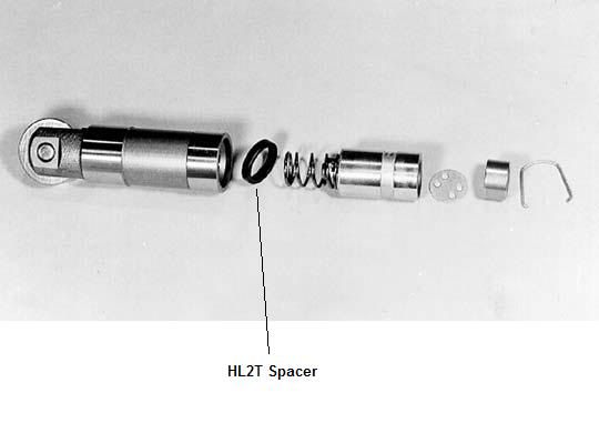

One thing that I've not been able to tell is what the difference is in the two. I've looked on the S&S website and the web and no where can I find an image of what the regular lifters look like compared to the HL2T lifters.
Can some one post a pic of the difference?

Travel limiters are nothing more than inserts that you install inside your hydraulic lifters after taking them apart.:eek:
They look like a washer that's got a 1/2" hole in the center,about 1/8" thick,and is able to fit inside the lifter body.They're are made for Evo's,Sportsters,and Twin Cams.
You can make them yourself,or get them from S&S.:D

Interesting, I took one of my lifters apart then forgot if that washer went on top of the plunger or on the bottom. No description of it in the manual. Guess I have them then. I didn't do my adjustments according to this type lifter.

The confusion on this topic comes from the term zero lash.
When adjusting with HL2T kits zero lash is set with the plunger resting bottomed on the spacer and then you adjust 6 flats above the spacer. This allows the lifter to pump up. leaving an air gap between the spacer and plunger. If you set at zero lash or just bottomed on the spacer the lifters have a difficult time pumping up and will be very noisy.
If you are not using HL2T spacers then you adjust from the top of the plunger travel down.
HL2T kits are adjust from the bottom up.
Hope this helps

Well, I'm still confused on what one looks like. Here is one of the old lifter I took apart and there was no washer in it. Just the spring, plunger and retainer.

No, my mistake. It wasn't a washer it was that shorter piece a the top of the photo. No washers, my mistake.
