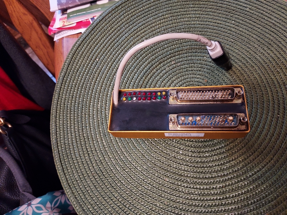

Ohm test ehc pins 28/6 and 27/6 not getting any continuity. Looks like 6 is ground circuit and 27 run, 28 start. I don’t have pins small enough to go into harness connector. Don’t want to spread pins in harness and then harness needs replacement in the backbone. The EHC has the vin written on it, so I am assuming,I’m it’s original. Feeling like I need to replace EHC. I ran a power test lead to the starter direct and it will crank the engine, but regardless of how many times the run button is depressed she won’t fire. Love the looks, the ride and the power, but after only 250 miles of riding, my ownership sucks. I’m sure the original owner had some clue of this.
