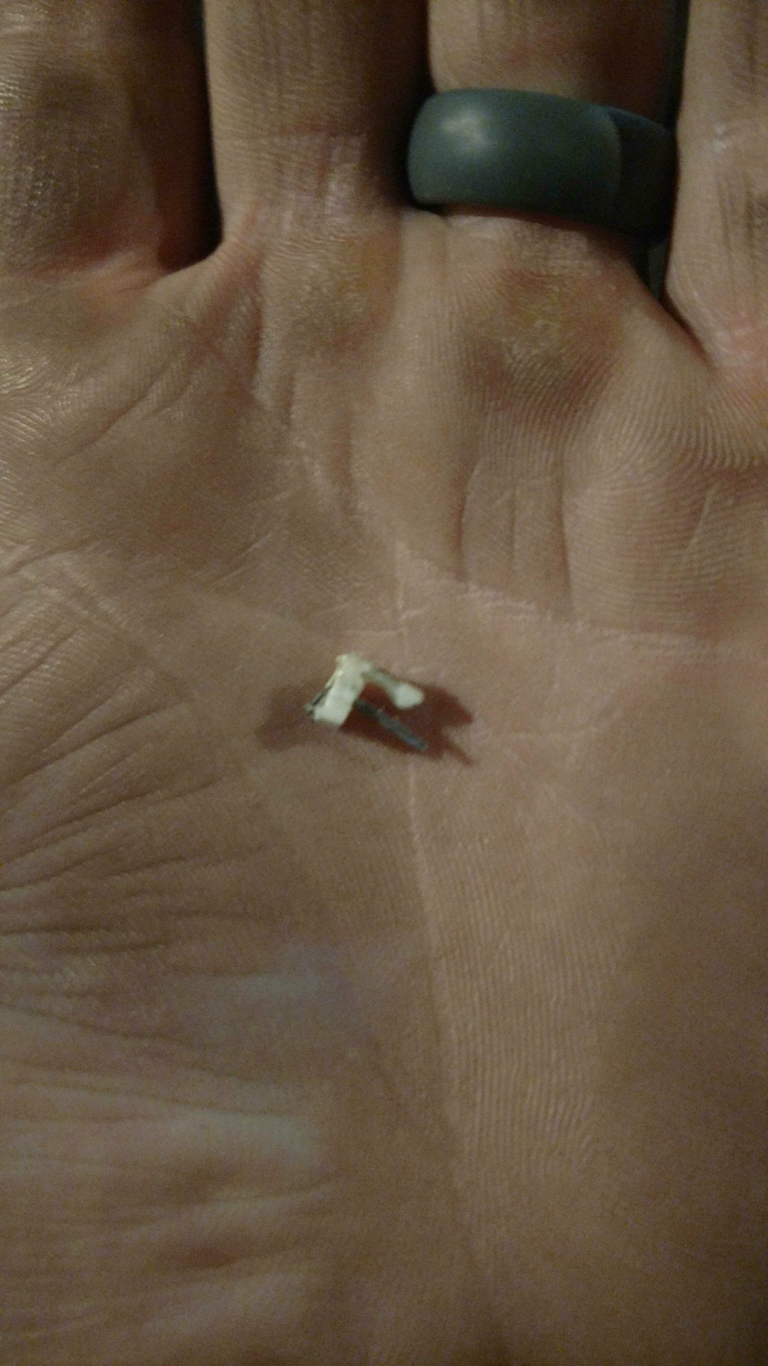

Just what I was thinking the wire is the one connected to the board correct?
This was attached to the board. Then the wire from the hand brake connected to it. Nothing on the board was arched out that I could see.
