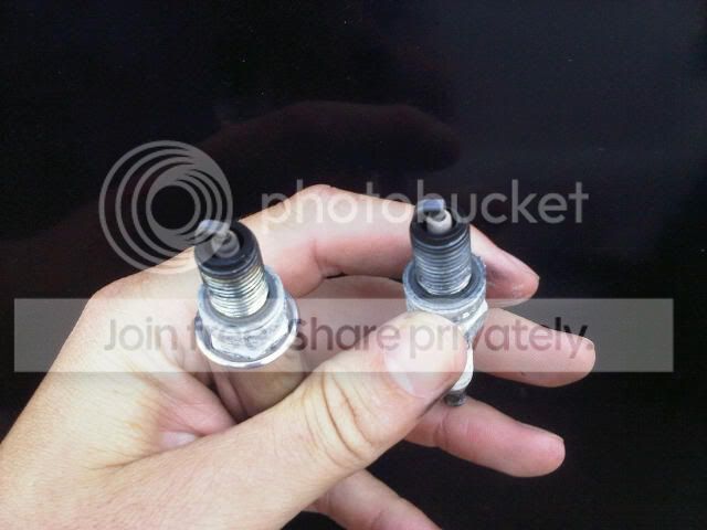

Ok so I am pretty sure I know what the problem is here but figured I might ask a few experts/smartasses for clarification for something I might be missing.
So I decided to go for a ride this afternoon, havent ridden in a week or so, my scoot is running great no missing, stuttering, pulls fine. I warm the scoot up for about 10 min before I decide to take off. Shit into gear and take off, well less than a 1/4 mile down the road I get caught at a red light and notice the back of my leg I can feel some major heat, not uncommon when riding all day in the summer but its 72 outside and I havent been running more than 15 min. I look down and both front and rear pipes are glowing BRIGHT RED
almost down to where they both meet under the breather. Just for reference I have the stainless creation disorder pipes, thick stainless as all of you know that have any of Clints creations. Keep in mind running like a champ! So since I have the triple x carb I go to cranking down to richen this baby up some, figuring I am sucking air, pretty much a full turn in and it goes to just up at the flanges, by this time I am back home and shutting her down.
Now what I am wondering is why did this all of a sudden show up? I rode all around thunder beach and never had this problem nor the last time I was out
......... Could my carb adjustment gotten out that bad( I know it is screwed up now for sure) or when it was cooling the last time blow a gasket behind the carb? I am assuming it is in the intake somewhere since it was both front and rear pipes.
Is there anything I should look into other than air leaks? Potential damage in anyway to the oil or motor in the short time it was running?
Thanks for your responses!
Here is a pic to get an idea of just how far down they got nice and red (sorry I didnt take one while hot all I was worried about was shutting it off)
