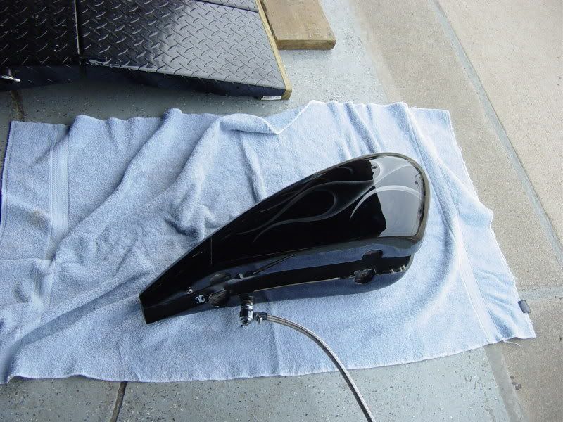

Does the 2 piece tanks have the same overfill tube inside that is used on the california models? I know on my chop its not used and the tank is plugged. you can see it on my tank here on the left. on the top half.
I believe that is the tube that alot of guys complaign rattles all the time. But I believe they are connected. Maybe you could plumb it with some stainless steel tubing and run it to the floor. Problem fixed!
Maybe?
