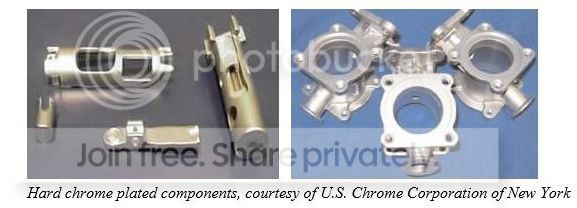

Hard Chrome Plating
Most people would not be very familiar with hard chrome plating. Hard chrome plating is chrome plating that has been applied as a fairly heavy coating (usually measured in thousandths of an inch) for wear resistance, lubricity, oil retention, and other 'wear' purposes. Some examples would be hydraulic cylinder rods, rollers, piston rings, mold surfaces, thread guides, gun bores, etc. 'Hard chrome' is not really harder than other chrome plating, it is called hard chromium because it is thick enough that a hardness measurement can be performed on it, whereas decorative chrome plating is only millionths of an inch thick and will break like an eggshell if a hardness test is conducted, so its hardness can't really be measured directly.
Hard chrome plating is almost always applied to items that are made of steel, usually hardened steel. It is metallic in appearance, and can be shiny, but is not necessarily decorative. Hard chrome plating is not a finish that you would want on a wheel or bumper.
There are variations even within hard chrome plating, with some of the coatings optimized to be especially porous for oil retention, others "thin dense chrome", and so on.
Many shops who do hard chrome plating do no other kind of plating at all, because their business is designed to serve only engineered, wear-type, needs. If a shop says they do 'hard chrome only', they have no service that most consumers would be interested in.

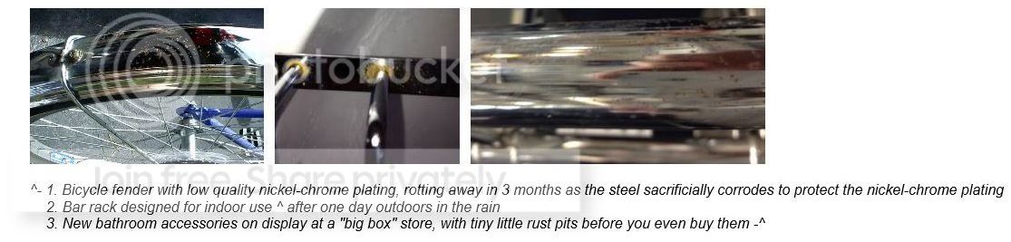

"Sacrificial" vs. "Barrier Layer" Coatings and Why Quality is Crucial for Chrome Plating
First an aside: Some readers may be familiar with the replaceable zinc anodes used on ships and outboard motors to protect the hull or motor from corroding. What the zinc anodes do is sacrifice themselves to protect the steel. Zinc is "anodic" to steel, and what that means is that when the steel is under attack and about to lose electrons (which would cause the steel to oxidize and convert from solid metal to rust), electrons will flow from the zinc to the steel to maintain the balance and protect it, so the zinc corrodes instead of allowing the steel to corrode. Galvanized roofing materials are coated with zinc, and function the same way: the steel is pretty safe from corrosion as long as there is some zinc left on it to sacrifice itself.
Now, could you use a nickel anode or chrome anode instead of a zinc anode to protect a boat's steel hull from corroding? Absolutely Not! Steel is "anodic" to the nickel, instead of the other way 'round. The current flows the wrong way. The steel will sacrifice itself to protect the nickel and chrome. So now imagine a steel item that is plated with nickel and chrome but there is porosity or pinholes in the nickel plating ... the steel will rust away, sacrificing itself to try to protect the nickel! If you've seen a 50-year old junked rat-trap of a truck or car, you may have seen bumpers with thin pieces of curling nickel chrome, and almost no steel, where the bumper used to be.
Unlike "sacrificial" coatings like zinc plating or galvanizing where porosity or a hole or bare edge may be no big deal, porosity in nickel-chrome plating is a disaster that doesn't merely fail to protect the steel, but greatly accelerates the corrosion of the steel. Chrome plating is a "barrier layer" plating; once the barrier is breached by a pinhole, very rapid rusting is unavoidable. A low quality chrome plating job with pinholes or porosity is much much worse than no plating at all; the plating electrochemically forces the underlying steel to rust.
Poor quality plating that is already showing tiny signs of rusting when you buy it is a manufacturing defect; return it, and don't let them harass you about "chemicals in your bathroom"! It is they who have chosen to distribute defective items; costly returns are the only way you can influence their policy of selling garbage.

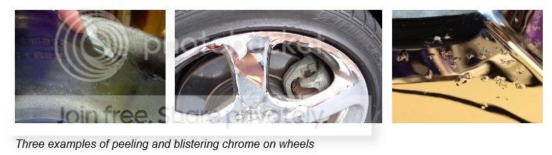

Blistering, peeling chrome?
If your chrome plating is peeling, this is virtually always a manufacturing defect due to insufficient adhesion of the plating to the substrate. Although exposure conditions can certainly harm chrome, and discolor it or make it pit, they won't make it peel! It can be very difficult for a plating shop to get good adhesion on some things (most commonly on alloy wheels because they are not pure aluminum), but if they can't do it they shouldn't sell it.
If your parts have peeling chrome, you should complain and not be deterred by nonsense about chemicals in your garage, how frequently you wash the wheels, etc. We'll say it again, we're that sure: peeling chrome is virtually always a manufacturing defect.

Hard Chrome Plating
