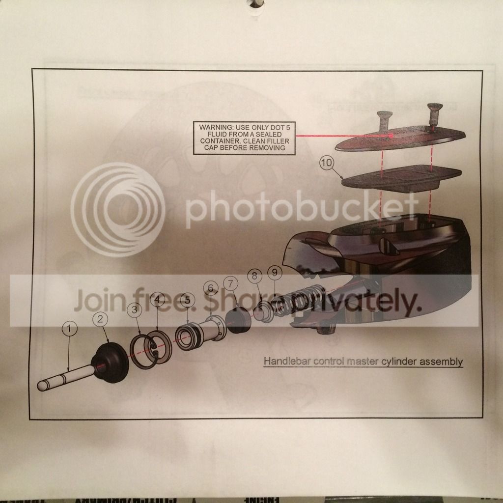

Ordered a rebuild kit for my front master cylinder because I changed brake fluid and bled due to it kept getting really soft. Well after the change I have no front brake. I know it is bled good. Got purple throughout and no air bubbles. Still no brake so after reading through here I ordered the kit from Curtis at WSW. So how hard is this of a task. Hope pretty easy I am fairly handy just need some expert advice and help. Anyone used this kit and how hard is it. Sturgis is less than a month. Hope like hell I make it for me 3 days then off to military duty again for awhile.
HAHA, you sound like me, mind was getting the same way, mushy front brake, thought for sure it just needed to be bled and possible air bubble in the line, mine would go mushy every so often, so bled the crap out of it, purple throughout, but still gets that mushy pull every now and then. I was told my another member to keep wiggling the brake level that first little bit to try and get any trapped air out, I used a Q-tip to deflect the squirt so it didnt make a mess, I felt like I wiggled the crap out of it forever. I need to just bleed the brake backwards from the caliper and pump fluid to the master with a brake bleeder, still cant seem to get the last bit of air bubbles out. It will go squishy every now and then still...
