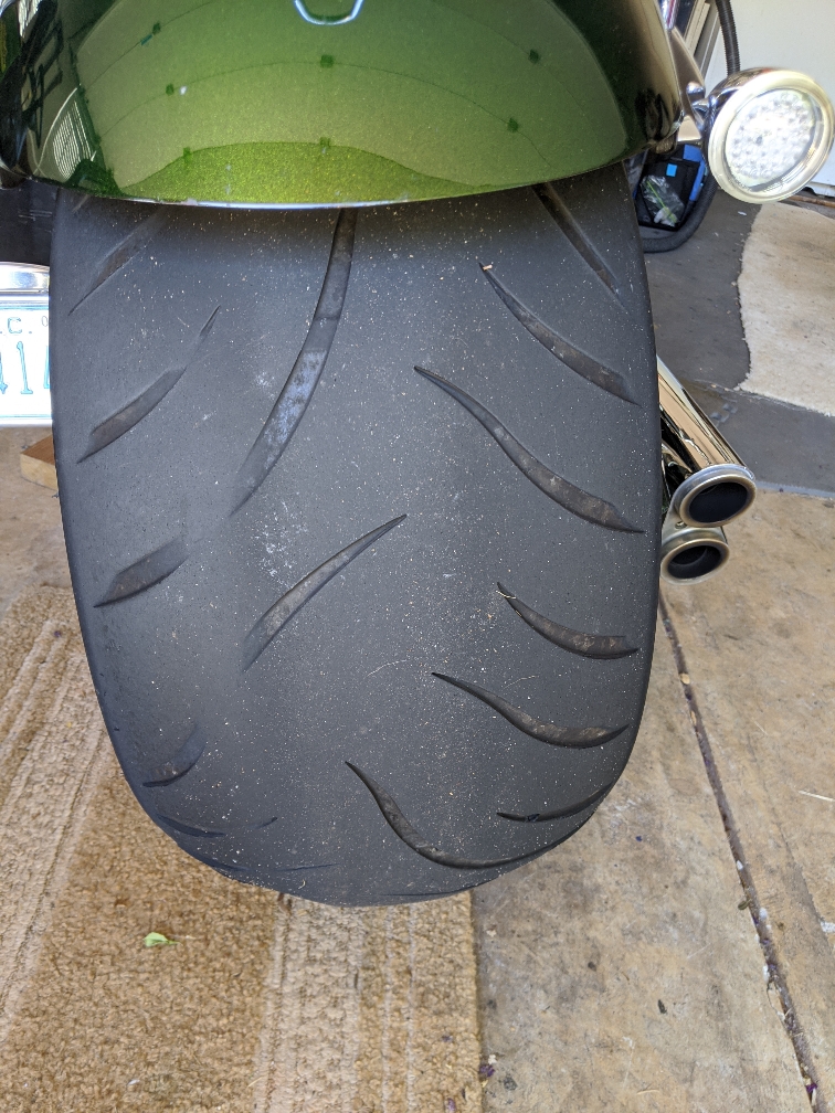

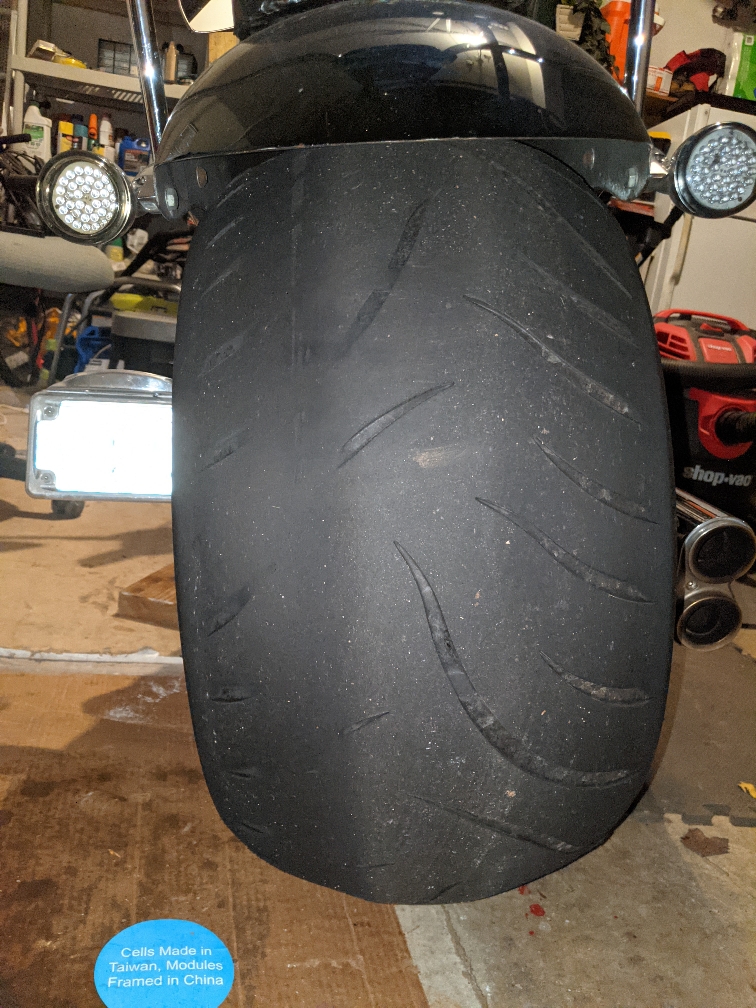

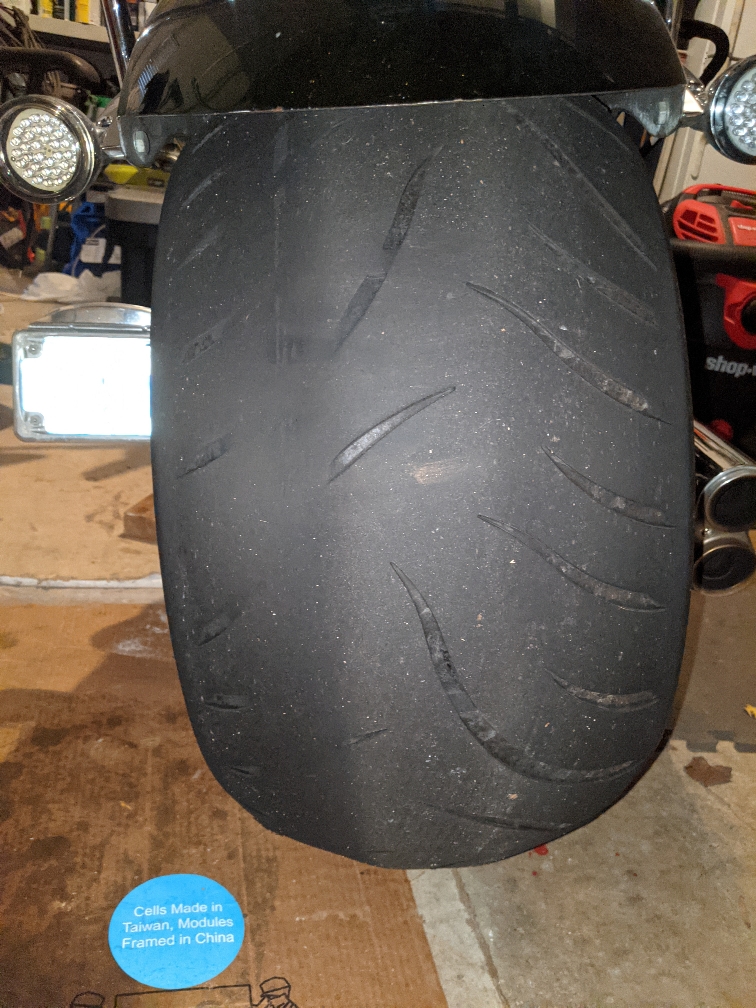

Technically yes and no. Compound wise, pressure wise, I've seen a tire clean up with different pressures. We are talking about high speed closed course, and within say 5 or less laps on a gearing/suspension shakedown; schooled my ass.1-everyone here is correct about once a tire starts to wear funny, you have no chance of saving it.
Which made me think... with back wheel off the ground, hands at 6 and 12 o'clock, is there any movement at all? That one bearing drop would cause the one side of the tire to wear. However, with the j-hook under the swing arm sides, that one adjust rod would point that out on the bearing drop as a variable; swing being square to the frame to axle and all that.2-have you been replacing your wheel bearings each time you replace your tires.
Then the northern crowd should go out to their car and look at the wear profile on their tires. Flat across the treads?... scratch my head on this one.
