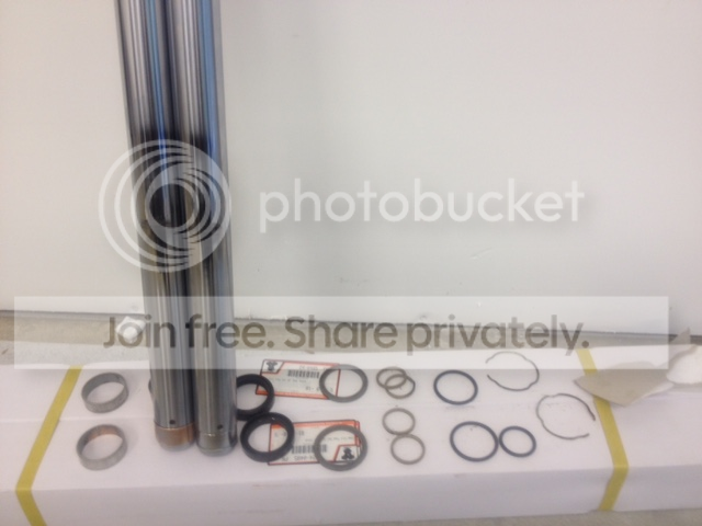

Just because you all like pictures this was the condition of the old forks notice the bushings worn out the damaged fork tubes ,not really apparent when is all assembled
