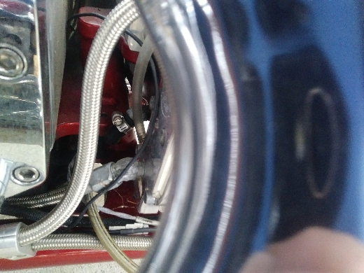

Can anyone tell me what this fitting should go to? It's an elbow to the left of the oil pump. It currently has a rubber plug with a hose clamp on it. It's on a 2006 K-9 . I've owned two other K-9 bikes and don't remember it on them.
Wasn't sure where to Post this, figured it may be an add on lol. Thx.

I think it is optional crank case vent. Take the plug out, connect rubber hose to it, point to ground and make sure to put one way valve on the end of the hose.
You can read old posts about the subject.
Paul.

1BMF ,it does not go anywhere it has a rubber cap on it.
I would just leave it alone as I'm not one to fix what's not broken.
I'm actually looking for another way to vent crankcase pressure I have the cone aircleaner and large vent from rear cylinder connecting after the carb. And small hose from front cylinder connected before carb on the intake manifold. Yet I develop a leak between primary and engine when I ride any distance. I'm hoping additional ventilation will cure this.

I have read the posts I could find on the subject. I just never saw anything positively identifying where the vent was I'll look at it when I get home, put it in a can and fire it up. If it is a vent I'll tie it in to the current crank vent system and see if that cures my leak . I'll let you know after I've completed it or found it wasn't a vent. Thx

You have a leak from the engine and primary or the tranny and primary? Both of those seals are well known issues, but easy to replace. Pull the primary cover and you can get to them both. Good time to put RED on the clutch hub nut and torque it to 150#. Get a new hardened nut/washer from Curtis or HDM. Let it cure overnight before you refill primary. Also make sure the primary vent on the back side of the primary is clean and clear.

You dont want a vent in the crankcase. The breather system on the 117's is designed to keep a vacuum in the engine. A crankcase vent will just cause a vacuum leak. There should be a check valve in the rear breather to let any positive pressure out of the engine, but does not allow air to be pulled into the engine through the rear breather. Big dog claims that this system stops oil mist in the crankcase and provides a better piston ring to cylinder wall seal. I don't know this for sure, but you would think it would boost hp slightly because it reduces drag on the engine. There is no air in the crankcase that the pistons have to push and pull in and out of the breathers.

The breather system isn't really a "breather" system per se. It's a vacuum system. The front breather line is hooked to the manifold. The rear breather has a one-way check valve. This puts a vacuum in the engine. If you unhook the rear breather from the check valve, there will be a vacuum in the hose.

Thanks for all the info guys I have not done anything to the bike after post as we are having a week long heatwave at the moment 105 yesterday... After the heat is over I had already made a system like Sven had suggested only I used scotchbrite instead of cotton. I'll try this one first then see what it does. And yes Sven the oil does get blown back from where it leaks it is right under the alternator. There's also a couple of bumps for bolts to go through making it difficult to have oil accumulate

Finally had a day where the weather wasn't triple digits so I hooked a vac gauge to the fitting and took it for a ride. There was no vacuum , so I hooked up a pressure gauge rode it and there was only a little more than a pound . Ordered outer and inner primary seals . And got a crank seal from the Harley dealership. I'll let you know if that fixes the leak when I get the seals . I also cleaned the area real good and used some white out to mark off places the oil could come from and it appears most of it is coming from the most forward lower bolt on the inner primary.

Sorry I had forgot about this post. After our heat wave the state pretty much caught on fire and didn't go out riding in all the smoke. I did take the primary apart after ordering and receiving all the seals . I found that none of the bolts holding the inner primary were torqued tight enough . Once tightened to specs the oil leak is gone.
