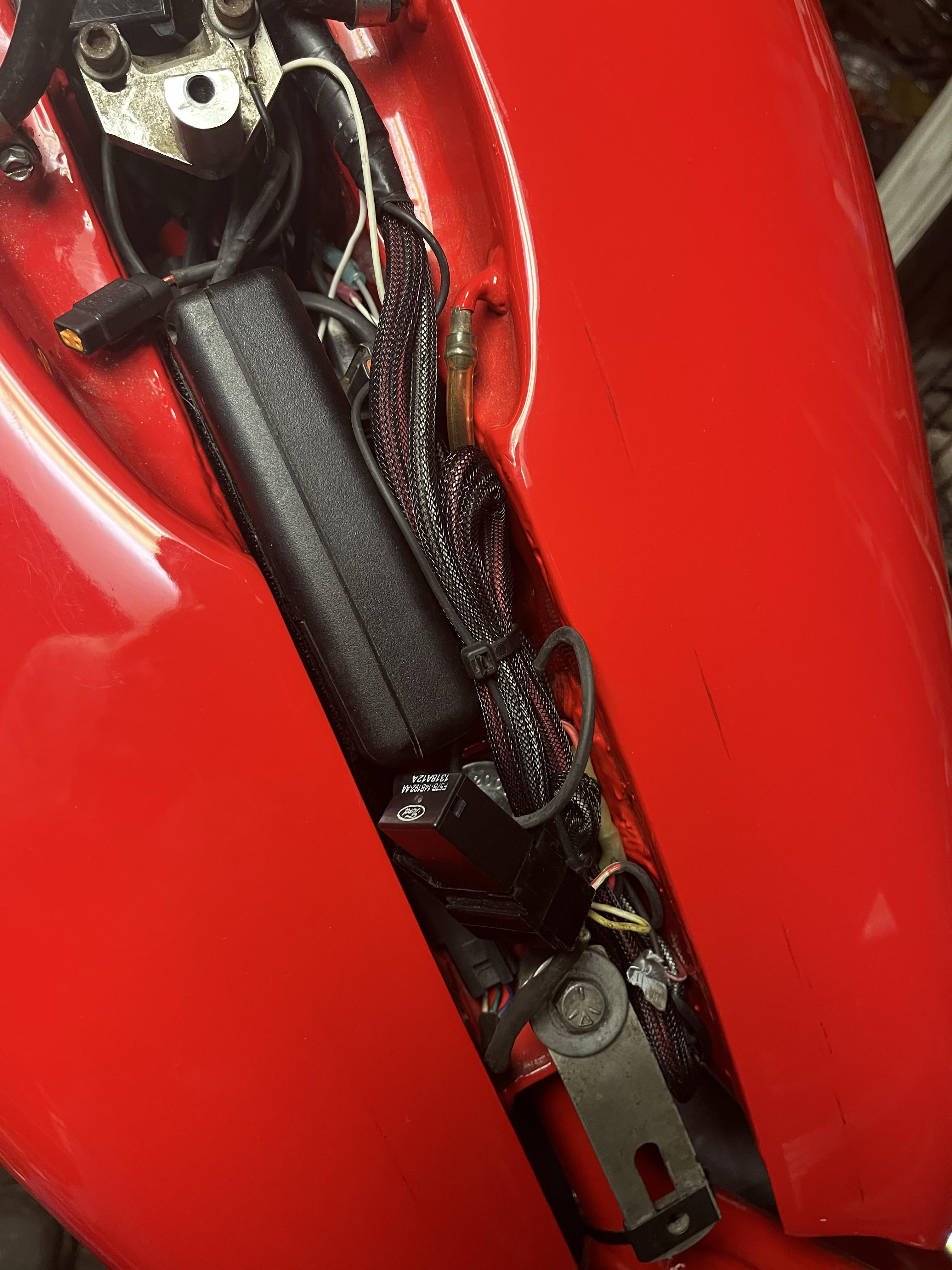

I’ll clean the plug On the EHC AND PUT SOME ELCTRIC GREASE BACK ON. IT
The Thunder Max is your ECM. Never seen one on a BigDog before. That’s a Harley ECM unit and EFI controller. Not sure what that is between your tanks…
Ribert R
The little guard dog ignition module is the keyless security, I’ll clean the plug and get greased back up. Why style should the ecm be if not the thunder max. I’m starting to think the man had not got to ride it like he says he did. Recent, he lost the key fob ,so he he’d that thunder max installed and it is suppose to be a stage 2 he said. And it’s throwing a code 325

I bet the EHC took a crap and this is the only thing the shop knew to do? Honestly your best solution is to get a new EHC and a harness from Curtis @ Wild Steed Worx. And if you are not comfy doing the work, you aint far from Knothead, 'Second Chance Customs'. He can for sure have you in the saddle ripping up Kentucky.

Ok I’ll check into it because I think it shit on me also. I have fire until I hit the start. But I’m gonna go to wild steed work and see the prices and get the money

Like I said that ECM is mostly installed on H-D. Check you-tube out. There are some videos on how to diagnose/clear the codes on the Thunder-Max. I’m not 100% sure but I think Thunder-Max is manufactured by Thunderheart. Could be wrong & probably am. I’m with Harry. Get that bike to Knothead and let him get it right for you.

If it was me I would call digital guard dog and talk with them about a new keyless entry and see if that's why forsure the bike is doing what's its doing... and then I would call thundermax about the ehc if that is part of the problem also.
Changing this bike back to factory and removing all the efi stuff and putting it back to carb is going to be crazy high money wise. I'm not trying to be rude or anything but it will cost way more than the bike is worth...04 mastiff only worth around 5500.00 to 8000.00 tops.

When I call them, just tell them how it’s acting and go from there. How much would you charge me to put another EHC on my bike. I’ll have to sell my sportster but ok. I’m still building it but I know a man that said he would buy it. Well he said he would pay the price at a shop and let me finish it for him

If it was mine I would sell it and the sportstet and buy a bike I could use. But that’s just my 2 €
