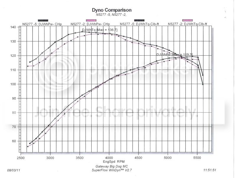

Finally dynoed the dog

Just picked up the dog from the shop today. Had it dyno tuned and pretty happy with the results. ended up with .0295 int. and a .080 main.
That is nice......
Good all round grunt and power on demand....
Congratulations on the build....
