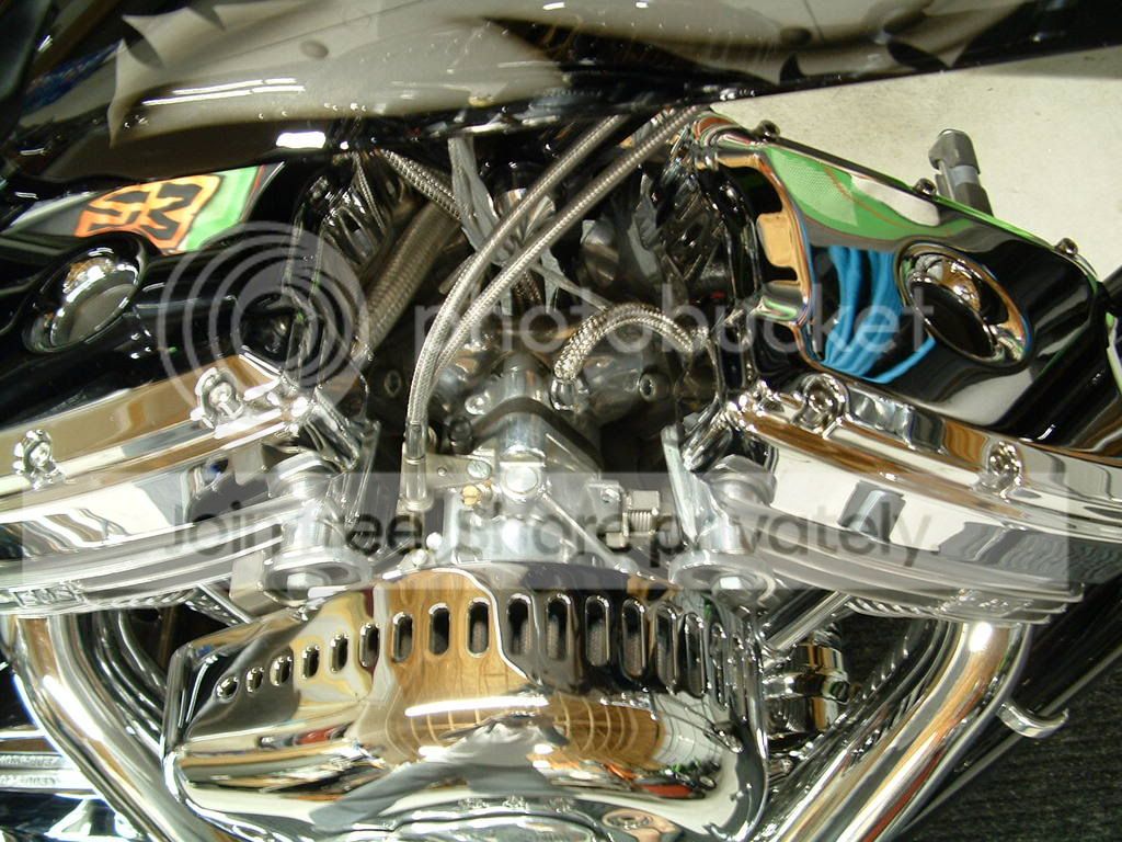

if you have a 06....you might have the TP rocker boxes on it......I had the TP's on my 06 K-9 and mine made more top end noise than usual.....last year the dealer replaced my heads...rockers and valve train to S&S.....now its alot quieter:up: they found one of my guides were out of tolerance...so everything was replaced under warranty:whoop:

Thanks for all the information. I bought this bike back in October but I just stated riding because I had my other bike up for sale. The tick has been in the bike since I started riding it. Thank you for the picture but I will have to look at my bike and see which ones I have but I am pretty sure I have the S&S just from looking at this picture. Thanks.
