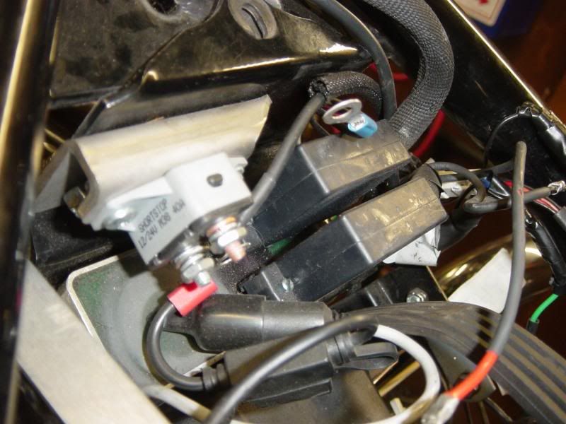

Also, I would check the circuit breaker to be sure its not poped and therefor not charging the battery. If it is, the bike will run off battery power with nothing re-charging it.. it will run for a while then poof.
