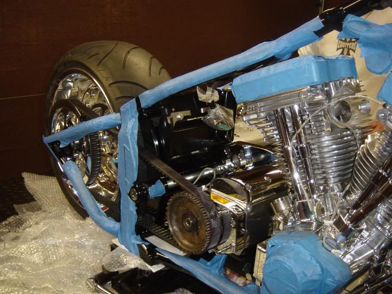

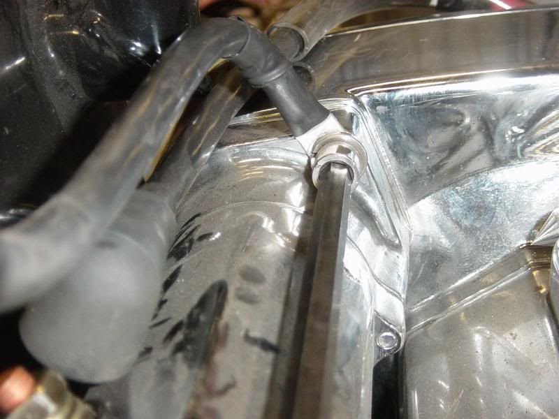

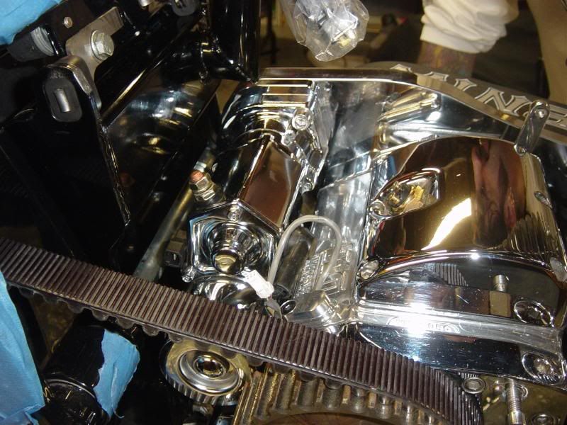

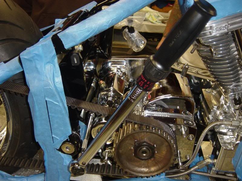

The reason his clutch rod came out is its spun into the pulley cover... and its a one piece
Here's a shot of the starter being pulled out
And it going back in
Note you shouldn't need to remove the battery tray to do it... mine was already out.
RVH

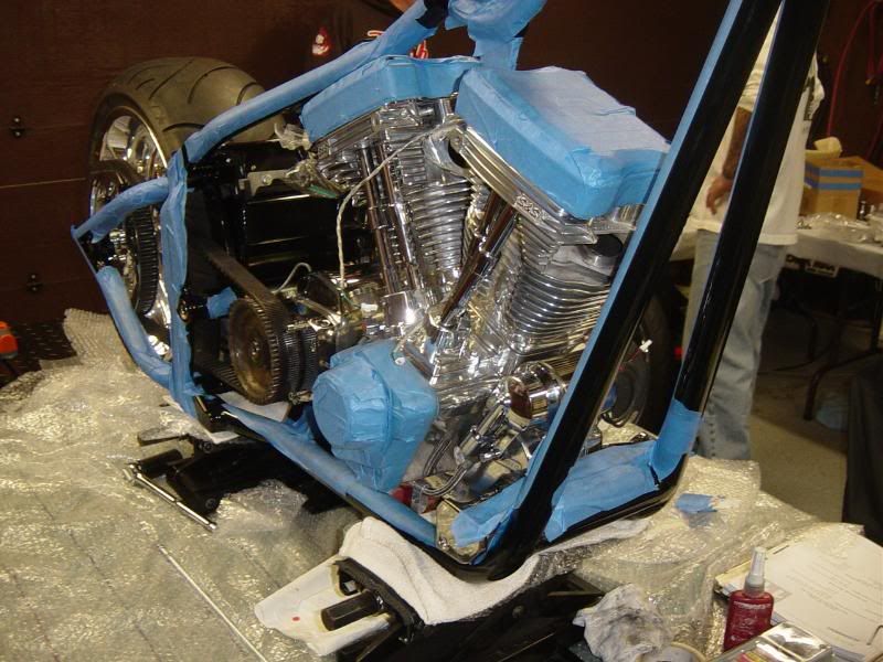

Thanks gents & yes, I'm up at 4:00 AM think'n about what I could do to get this going sooner. Went ahead and ordered the 2.0kw from the guy on ebay. Supposed to be here in 2-3 days.....Gas, wish I'd thought about the tape. Not so much for the frame but I did put a small scratch on top of my primary cover when I let the starter gear touch it. Had micro-fiber towels all over the area trying to protect it but chit happens. I didn't cry but I did pop a top after that, lol.
Yeah the painters tape is a must if you plan on doing any amount of wrenching. In those high impact areas or areas where you know you'll be busting a wrench against... I have been known to use like 8 layers.
At one point my bike looked like it was blue and not black!
