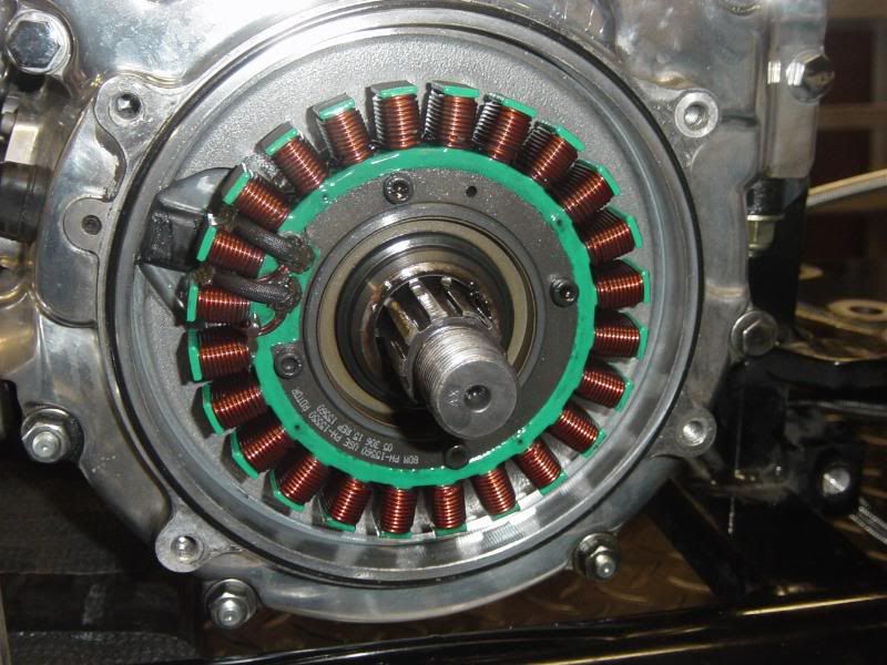

Your stator is the MC equvilant to your car's alternator
There is a plug just in front of this... you can see it slightly in this pic...
