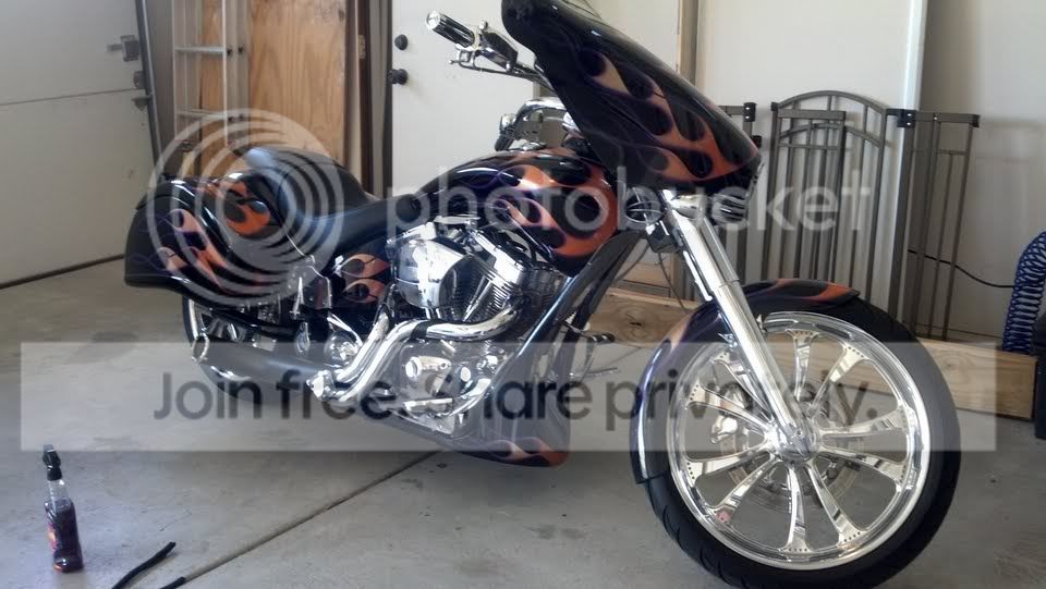

I bought this bagger and thought the stock pipes were lame and too quiet. Problem is no other pipes other than Vans and Hines Big Radius are made to fit. So I retrofitted these Paul Yaffes that are made for a Street Glide. Had to use the plugs to fit the current ECM module and splice them onto the O2 sensors that are made to fit these pipes. All good right!! No, since the ECM is an EPA locked version my engine light is coming on and it is slipping into skip fire mode, which limits your engine. So I bought the 55-5090 pretuned Pro Tune from S&S.
