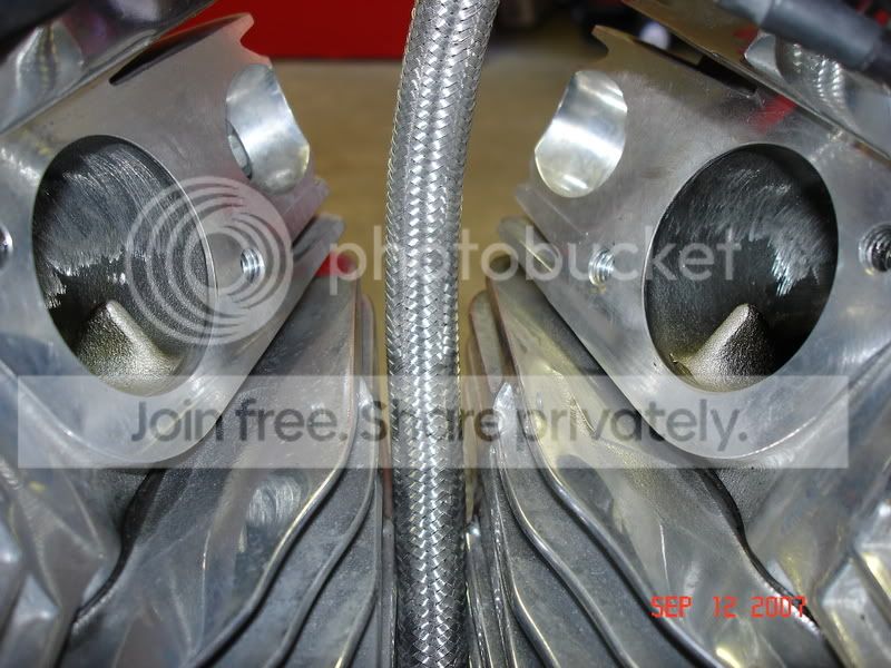

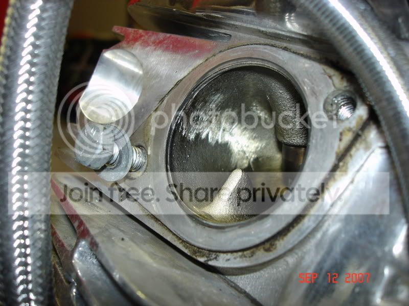

Here are what they look like and where they are installed. You'll like the Triple X mod on your carb as it makes it more responsive. Your pipes might just need to have the baffles opened up or cut down or just do the "washer" thing in them.
Here are the spacers. The left one is on top of the "restrictor" plate!
Here they installed on the cylinder head. Get a new set of seals when you order the spacer plates.
