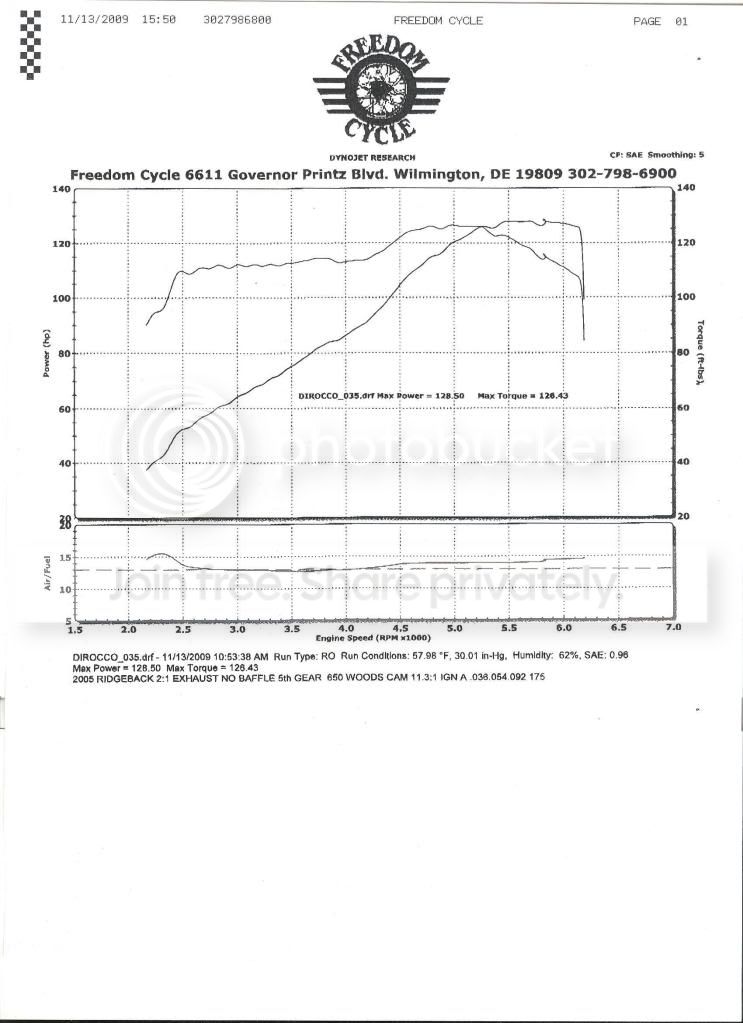

Well I got my bike back from getting the transmission fixed up and they put it back on the dyno for me and I thought I would share the numbers with you. The Deadone said I would be at 135 hp and if I had that R&B racing pipe I think he would be right on! :2thumbs: It's a rocket!
corrective #'s:
128.5 hp
126.4 tq
uncorrective #'s: Temp in high 50's.
133 hp
131 tq
Jets:
36 int
92 main
54 air bleed
175 thunderjet
28 deg timing
This is with a pipe that doesn't produce performance either. I'm gettin ready to purchase the LSR 2 into 1 pipe. Hoping to get another 5-10 hp & tq. :2thumbs:

Those are Really Great numbers, now seeing that it was done on a bad spark plug wire!
Yesterday Gregg called me and we found that he had a intermittent plug wire! They usually don't just go bad all at once, so I figure that it was somewhat bad during his last dyno pull.
You guys better watch out for this machine, It's a BEAR! and still set up on the conservative side of things too! :lol: Wait until he ups the anti and turns it "REALLY" loose! :whoop::whoop::whoop:
Good Job Gregg! :2thumbs::2thumbs::2thumbs:
free
Hey Gregg see that blip or littlle curly cue on your dyno sheet ? It,s around 5800 rpm. I could,nt feel anything when I did the run. So I just thought maybe my rpm pick-up was bouncing around or lost a signal briefly.As you can imagine running full throttle at 6k makes for some vibration. Anyway the light bulb lit with the spark plug wire issue. Maybe what we are seeing is the start of it. I really cant say if it helped or hurt on the peak numbers. My gut says how could it help. Other runs are around the same numbers though

I agree, but I can say after replacing the wire the bike never ran so good since I got it back. Well come spring when I get that LSR pipe, be ready to tune her in! I must say that Freedom Cycle has been great to me! :cheers:
