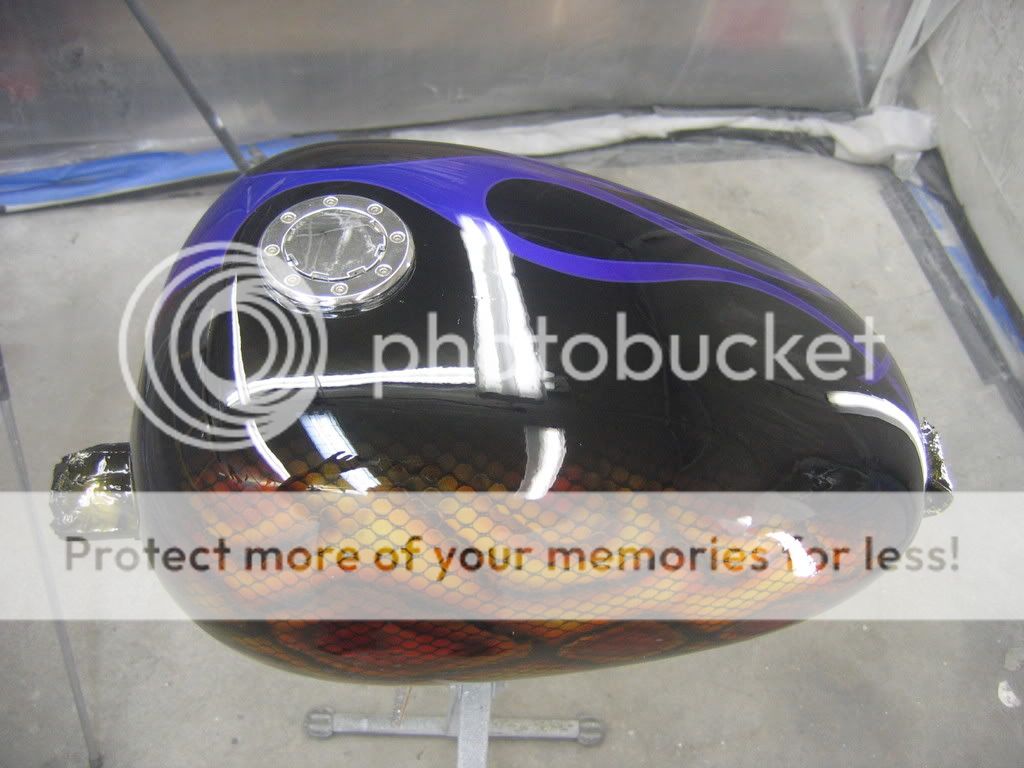

Okay, so I was cleaning the garage and discovered two old fiberglass motorcycle gas tanks. Well, had to do something, so I decided to paint each half of the tank something different. One side is conventional old school flames. The other I decided had to be something I have never done, which is snakeskin.

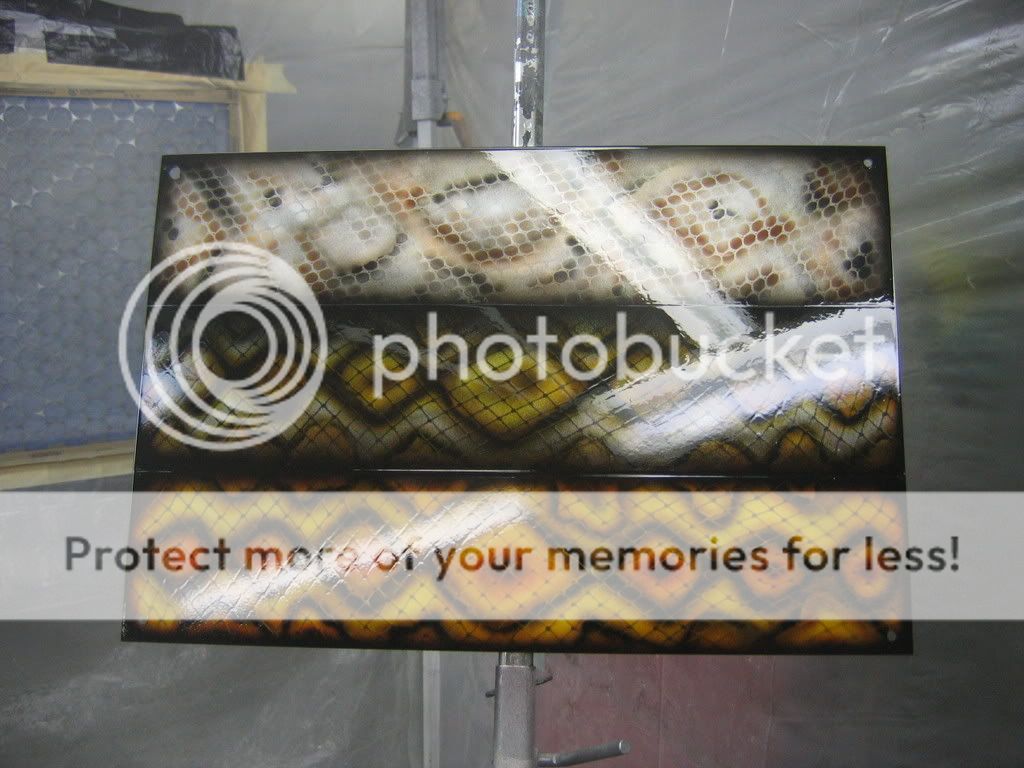

So, I took a piece of metal, painted it black, then layed out three sections. I figured this would be my practice before spraying on the tank. So, I played around with colors and design and this is how my practice panel turned out.

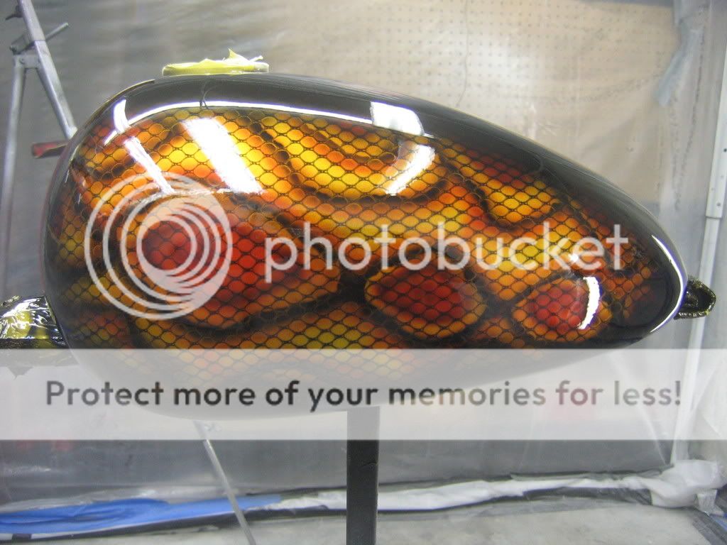

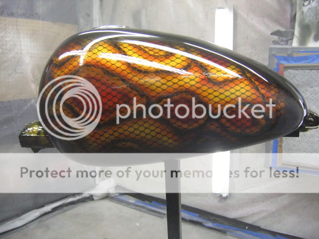

Then I picked the design I thought would look best on the tank and sprayed that. This is the result. I may add some more design or graphics to it, not sure yet. So, if you saw this on a tank, would it seem to be snakeskin?

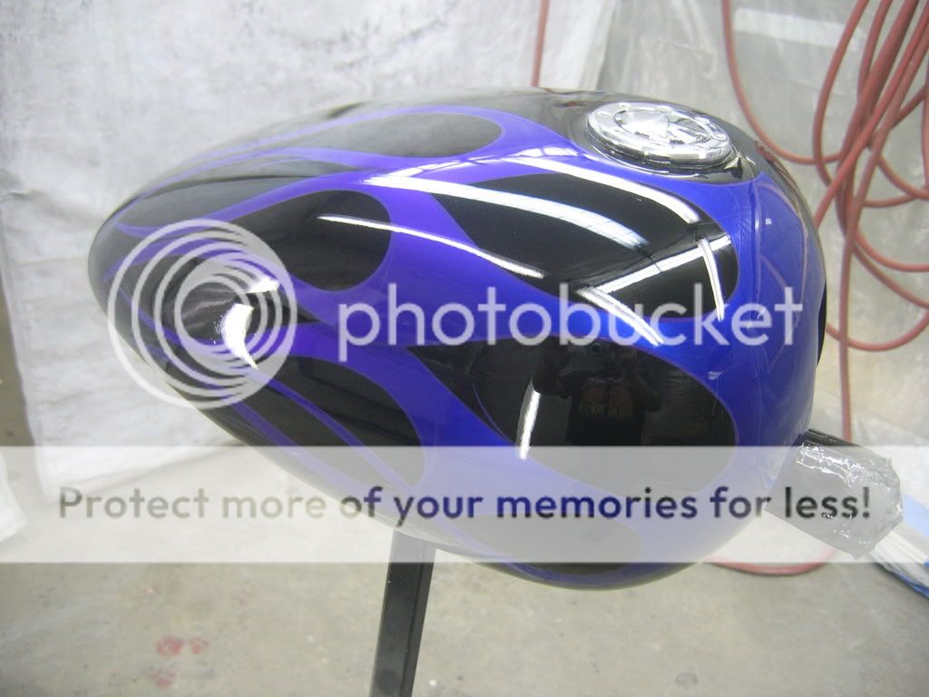

Here is the othe side

I first tried using a fish net (actual fish net) but didn't like it. I then took a laundry bag (which is what I used on the tank) and I like that look better.

At first I wasn't sure about it until I saw the tank actually painted. It definitly looks like snake skin. Cool idea.

That's how I do it! Try taking the end cap off your airbrush and stipple (lots of little dots) of browns and tans. This makes the overall effect more realistic and textured. And highlites & shadows to each and every scale if you're feelin a little OCD!!!! Good job!
