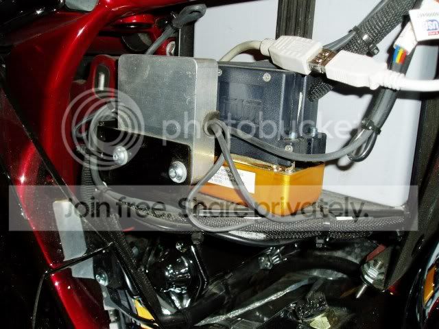

New IM Installed at LAST!
Geez, took me long enough- but I have good excuses: The Primary Spousal Unit went to a garage sale, and bought the whole damthing!
OK, on '07 K9, the Thunder Heart wires are too thick to match the BDM size connectors, many have noted that. T-H provided a set of BDM size pigtails and matching connectors, so all I had to do was chop the new IM and splice in (with solder). Now I have a "hot swappable IM.
Next problem, thcker wires caused a VERY tight fit between the IM and the EHC, because the wires do not exit the module in the same position as the stock units.
Enter Hoggie bud who has conjured his own CNC milling machine. He did a little mod on the case of the new IM.
NOW it all fits without undue pressure between the IM and the EHC! Use blind nuts, because the stock IM is threaded, and the 5012 is not - no clearance between IM-EHC for regular bolts & nuts.
BTW, T-H engineer provided a custom map for Big Dogs, as the pre-programmed maps are geared more to H-D bikes.
Last step was that I had to reprogram the Tach Calibration, from 0 to 1.
All is well, pics attached, mod and final install...

Looking good Slow Vince....
Got to love it when everything comes together..:whoop:
The Thunderheart people are some great people to work with and know..:D
They have done a ton for me and resolved a number of issues with my EFI bike..:2thumbs:
