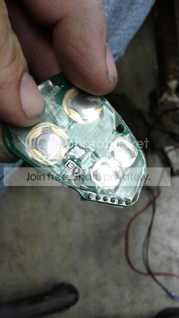

Was working on Shain's bike today. The previous owner had a start button mounted to the top of the valve cover, so I took the control board out to see if it needed cleaning. Upon inspection, I found none of the buttons worked. I peeled the plastic off and checked under them and they were clean. I started doing continuity checks and found it had a ground problem.
In the picture below, the diagram shows how the grounds connect between the buttons, then stops at the ground for the brake light switch.

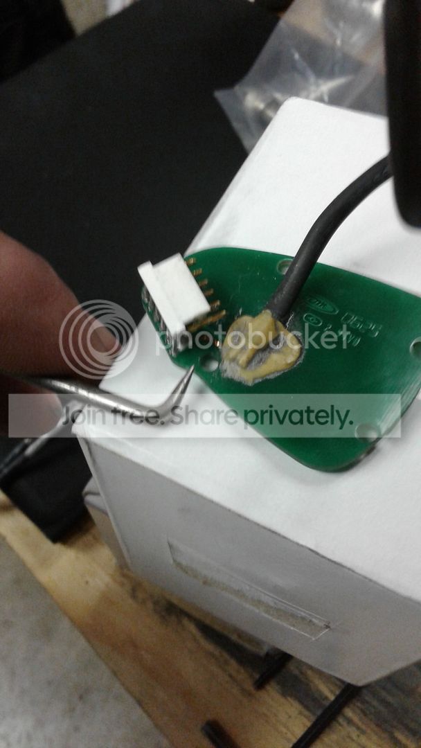

The circuit board then continues on the back side of the board to the ground pin.
See pointer in picture.
What I found was the circuit on the back side was burnt completely out of the board.

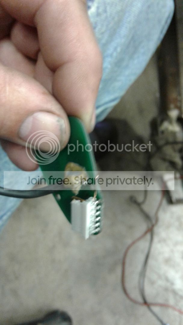

So I took a small piece of wire and soldered it to the brake switch ground. I didn't want it to touch the button, so I ran it over the edge of the board.
And soldered it to the terminal.
Put it all back together and it worked like a champ.
