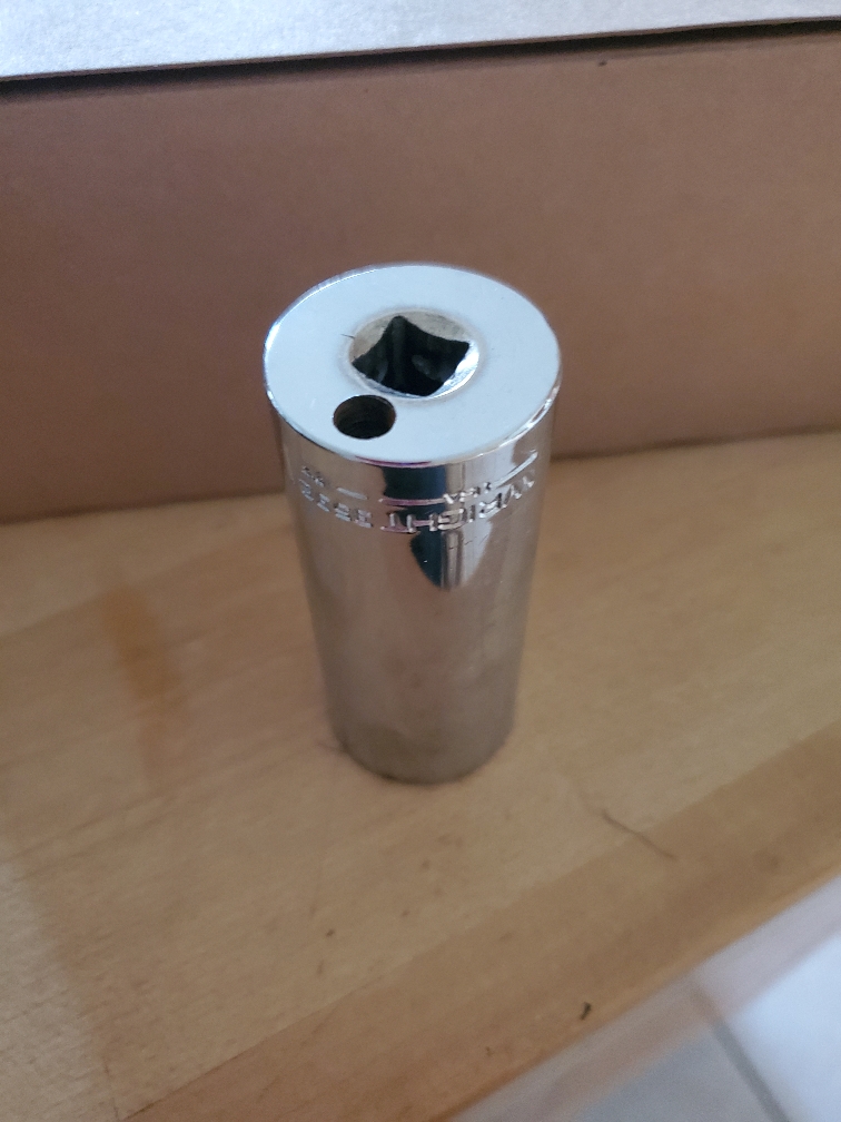

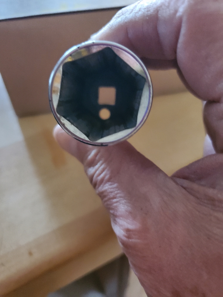

First of all, you don't have to remove the rocker box to replace a compression release. If no one comes up with the tool, ( I forget who has it) I'll tell you how to make one out of a regular socket. When I'm in my shop tomorrow, I'll take a picture of the one I made.
EZ Dog
I just took a thin wall deep socket and drilled a hole in the side way up near the socket head. The hardest thing was to find a very thin walled socket.
