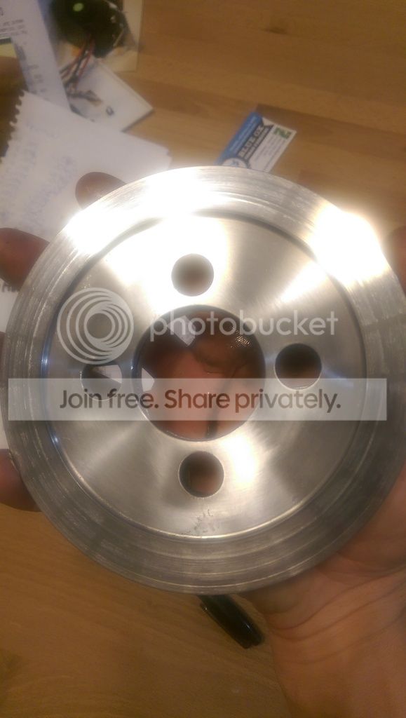

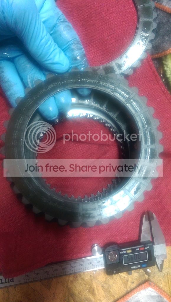

Finally got the chance to pull my clutch apart and low and behold, it wasn't the clutch hub nut which I fixed 1600 miles ago.
Wore a nice little groove in the clutch plate. Pictures suck, I must have got my phone wet or something pictures all just started coming out blurry a few days ago, sorry but you get the idea. Ordered the new pressure plate and Energy One shipping me a new friction to replace that and a thicker steel plate to bring my clutch back up to spec. Energy One said the pack stack height should be 1.97", mine is floating around 1.955" so we will bring it back to full height as the friction plates are not worn down still looking at .094-.095 for all the plates. :2thumbs:
Kent at Energy One said due to the 12 plate clutch having thin steel plates (0.060) it's likely they will wear down faster than their friction plates. Go Figure, you can slap some thicker Steele plates in there to help bring the pack stack height back up. The 9 plate clutch has the thicker steels, not sure of the exact size. Funny enough when I took my clutch apart I had the large thick Steel plate (.120) in the back where it should be and then 2 out of the remaining steels were already sized up at 0.080 instead of the standard .060, guessing baker put them in to bring it to full spec originally as the bike only had 3k miles on it when I bought it from the original owner I'm probably the first one in there.
